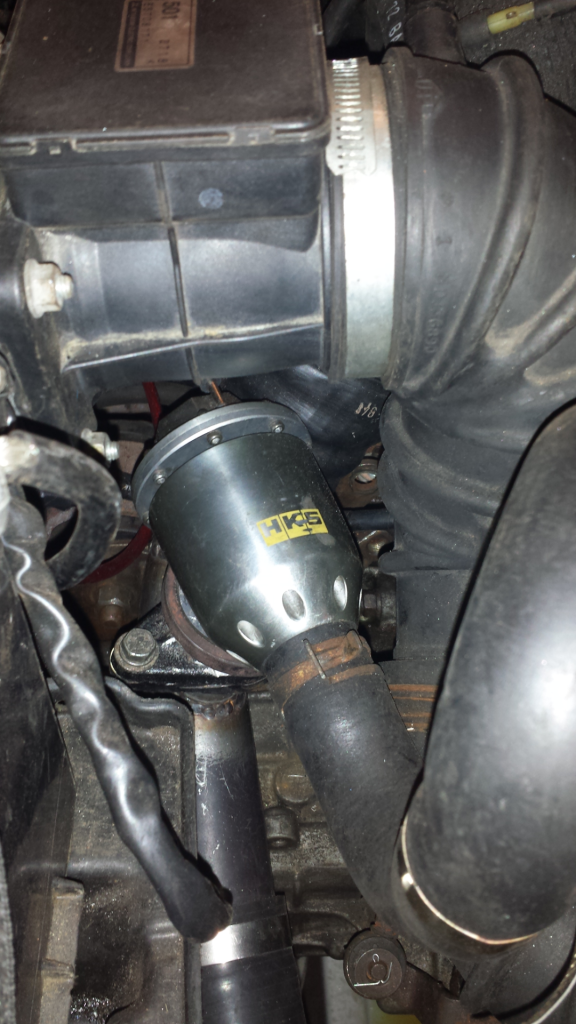

Made an HKS-to-DSM BOV adapter. I lucked out and picked this up for cheap, and it's an authentic one too.

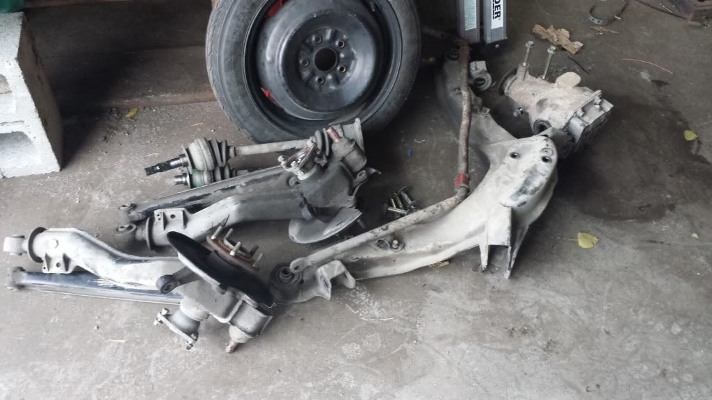

Also brought home an AWD rear end...freebie :).
