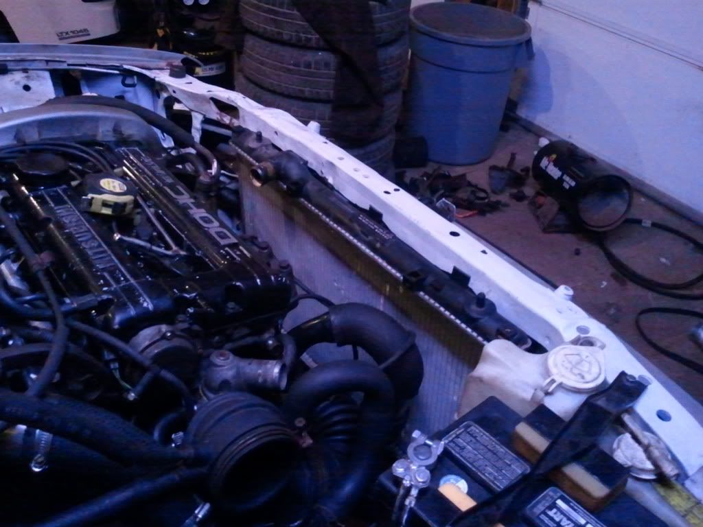

It's a big pic, but this is what a Neon 2.0 rad looks like in a Colt. It's a near-perfect fit, which is great :). It's a bit thinner than the stock rad, which also works for me, since I'm limited in clearance for a fan. Very stoked right now :).
I need to get an inline coolant filler for the upper pipe, since the inlet is still much higher than the thermostat housing. Easy peasy!
