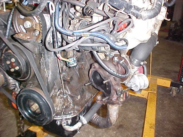

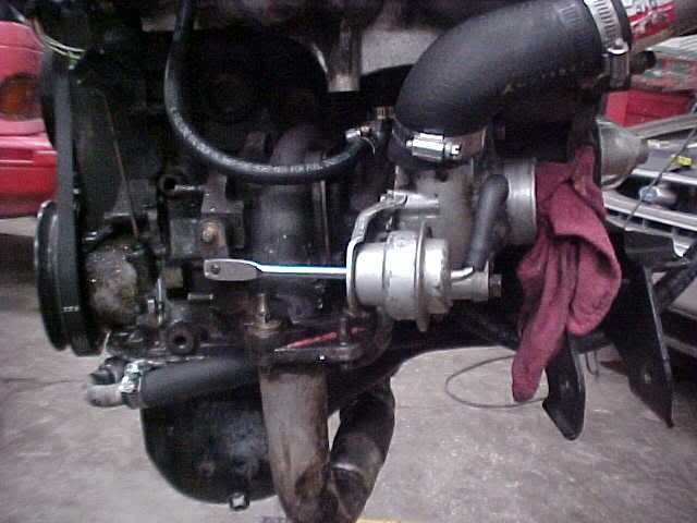

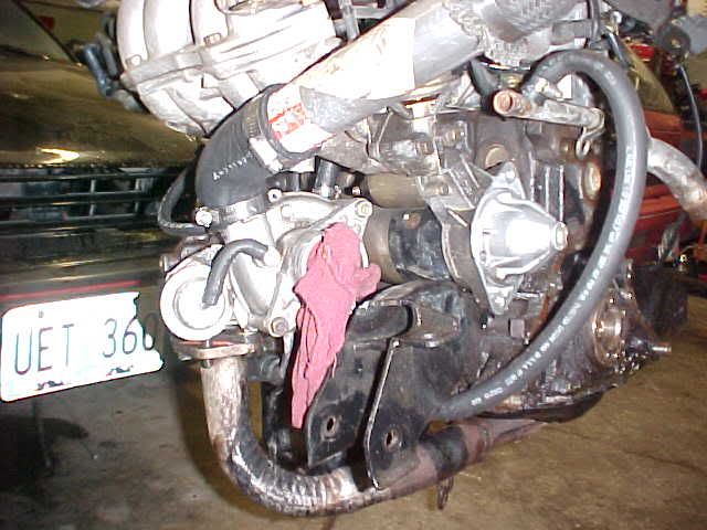

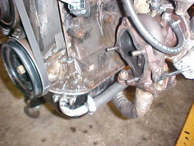

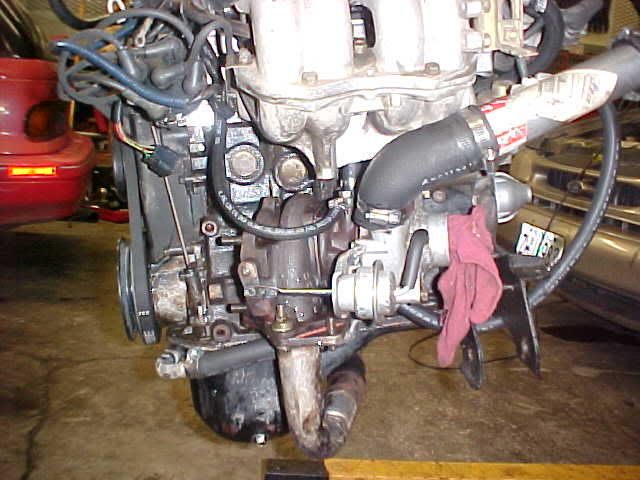

If I can run pump gas with a turbo then you can do it with upped compression.
If you have any questions about this set just ask.

:o I guess that setup would work - pretty stealth at the least. I notice the inlet manifold brace has been removed to make room. How is the turbo being held up in that postion?

It still had the exhaust mount on the front of the block. Yes, it was a very tight squeeeeeez.
