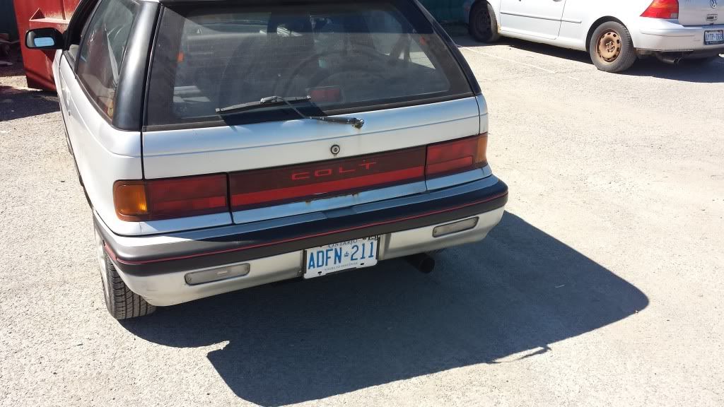

Exhaust DONE! :)
HpAuto.ca pulled off an awesome exhaust again, not a single knock, tick, or bang. Complete bolt in too, all the stock hangers. Can't even tell it's not a stock exhaust (kinda).
