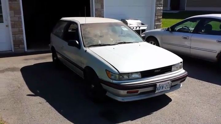

Drove it around the block today :).
3" open downpipe, dirty/dusty everything, and complete success. I need to get an aftermarket cooling gauge I think, because I can't trust any of the logs. My fan shut off at 101*C...which is 23*C higher than it should have. The dash was showing normal temps though. Grr.
Here's a video of it idling on the Evo ecu, smooth as silk :). Yes...the 13G is that loud through the open downpipe, lol.

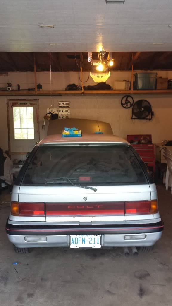

Every time I turn around, something falls off this car :evil: . I'm prepping the rear bumper for the black stripe and notice one of the corners is kinda pushed out where it bolts to the arch. I grab a 10mm socket, reach down...SNAP. The whole tab just falls off the arch. More rot...awesome.
I really think I need to re-shell this car, if I could find another colt once this one is on the road. I'd much prefer a sedan, so if anyone has any lines on any...willing to travel!

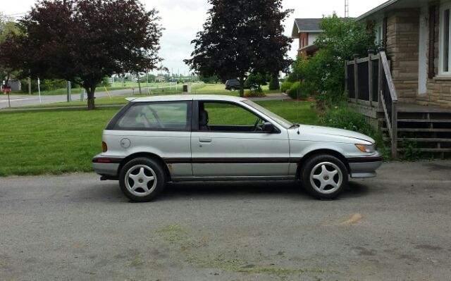

Finished the Mirage-ification :). Looke waaaaay better IMO.
Besides, two silver GTTs in one small city would confuse people ;).

New speedo cable is in, and I think these wheels will be perfect :). Thanks Tim!
PostPosted: Sat Jun 01, 2013 12:50 pm
Check the one tire for a slash! That and one rim needing more weight than usual, were the only issues I can remember. They've been off the car since 2010? Happy to see them put to use.
PostPosted: Sat Jun 01, 2013 1:03 pm
Posts: 860
No worries, I'll be throwing new rubber on before I put them on the car. The steelies on it now have tires that will be better for the safety. They're the perfect look for the car IMO, simple and classic.
