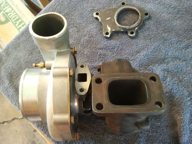

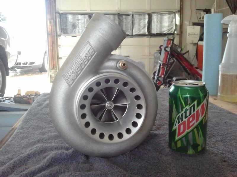

Well I guess I know which route I'm going with the car now lol Guy told me it was brand new over the phone and when I got there he told me it had a couple dyno pulls on it. Looks brand new though with zero shaft play and has the billet wheel so I guess $550 is a decent deal :D Next on the list ecmlink.

Looks like it might haul ass if you can get all the parts you need to make it happen. Please stick with the T3 setup. You will be happy you did. What turbine housing is on it?

.63 turbine housing .70 compressor Dude said it spooled @ 3500 rpm on a 1.6 hone Hmmmm lol

The .63 is pretty small, but not that small. Expect 5500rpm full boost. At least. But boy oh boy will it be worth the wait.

I can live with that. Should pull as far as the motor will rev. What manifold and wastegate would work best? Also Is the 5 bolt t3 flange the same as dsm? And I herd a long time ago that honds bseries has the same manifold to head bolt pattern as dsm is true?
Also here are the rest of the specs on the turbo Precision ptb500-6262sp 2.450" Ind/3.228" Exd
2.795" Ind/2.437" Exd 76 Trim
1992 Galant VR4 #680/1000 A few mods

I would go with either a treadstone or a turbonetics manifold. We have good luck with ebay 38mm wastegates.
It is the honda H series manifolds that are close. You still need to drill the holes out though. Just get a manifold for a dsm. I think there is even a treadstone on here a guy can't get rid of. A dsm flange and a T3 flange of any kind are not the same. Both inlets and outlets.
