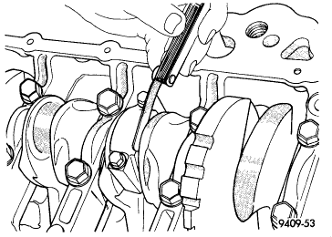

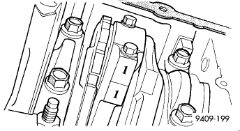

Crankshaft Journal Tolerances
Crankshaft Main Bearing Journal Diameter 2.2433-2.2439 in
Connecting Rod Journal Diameter 1.7709-1.7715 in
Maximum Out of Round All 0.0006 in
Maximum Taper All 0.0002 in
Bearing Clearance Main Bearings 0.0008-0.0020 in
Connecting Rod Bearings 0.0008-0.0020 in
Crankshaft Endplay 0.0020-0.0070 in
Tightening Specifications
Crankshaft Main Bearing Caps 51 ft.lb

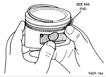

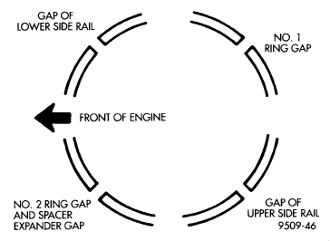

Piston Ring, Engine
Piston Ring End Gap
Note: Minimum Compression Top 0.0098 in
No.2 0.0138 in
Oil 0.0079 in
Piston Ring Side Clearance Compression 0.0012-0.0028 in

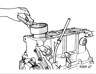

Piston, Engine
Piston Diameter (Standard)
Note: Measured at 90 angle to piston pin 3.3465 in
Piston Clearance 0.0008-0.0016 in

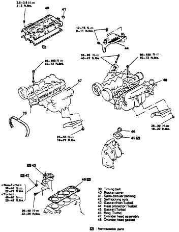

Service Specifications
Cylinder Head Warpage Limit 0.008 in
Cylinder Head overall thickness 5.197 in
Note: Minimum thickness is overall thickness, less warpage limit, combined with amount of grinding of cylinder block gasket surface.

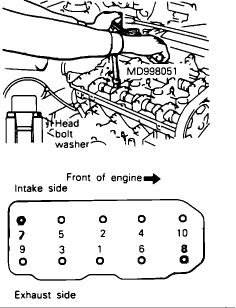

Torque Specifications
Cylinder Head Bolts 72 ft.lb
Valve Cover
Cylinder Head Cover Bolts 3 ft.lb

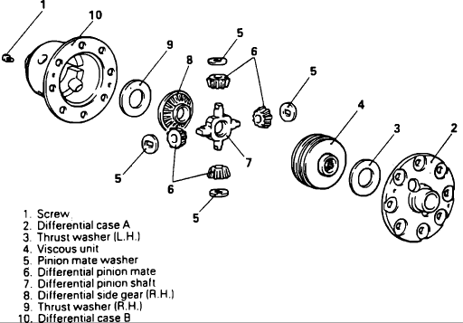

Exploded View Of Differential Carrier (W/Limited Slip Differential)
Remove attaching screw from differential case A.
Remove differential case B.
Remove left thrust washer. NOTE: Since thrust washer from left side is of a different thickness than the right side, it will be necessary to mark the washer in some manner for assembly reference.
Remove viscous unit, pinion mate washer, differential pinion mate, pinion shaft and righthand differential side gear.
Remove right thrust washer. NOTE: Since thrust washer from right side is of a different thickness than the left side, it will be necessary to mark the washer for assembly reference.

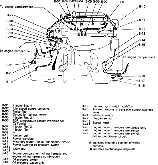

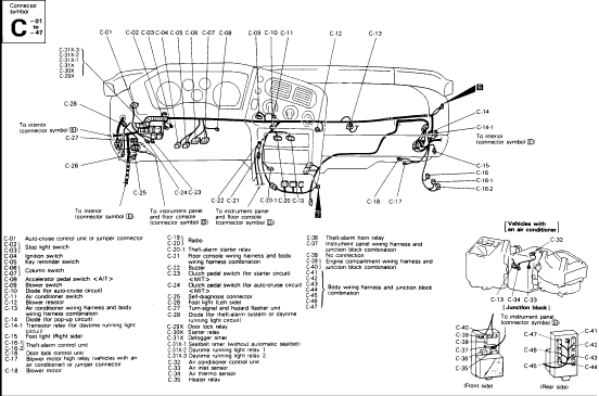

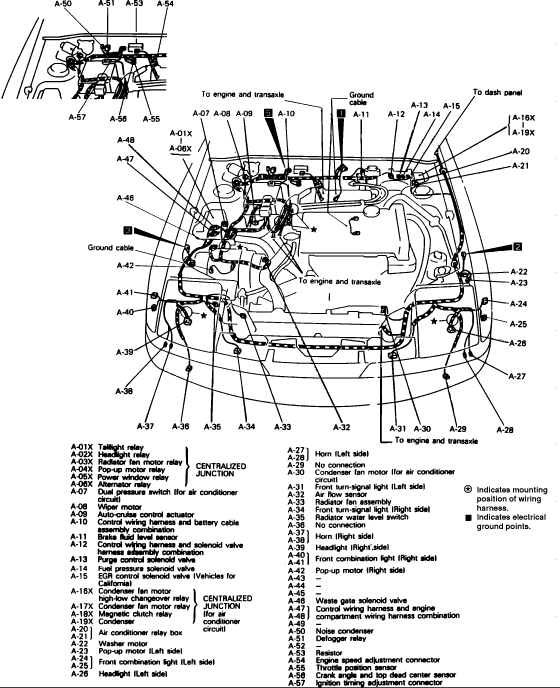

Component locations
A/C Control Unit: Under RH Side Of I/P, Above Heater Assembly
Air Conditioner Relay Box: LH Side Of Engine Compartment Cowl, Near Strut Tower
Air Flow Sensor (1.8L): In Air Filter Assembly
Air Flow Sensor (2.0L): RH Front Corner Of Engine Compartment, In Air Filter Assembly
Air Inlet Sensor: RH Side Of I/P, Above Heater Assembly
Air Thermo Sensor: RH Side Of I/P, Above Heater Assembly
Alternator Relay: RH Side Of Engine Compartment, Front Of Strut Tower
Auto-Cruise Control Unit: Behind LH Side Of I/P, Left Of Steering Column
Auto-Cruise Control Actuator: RH Side Of Engine Compartment
Automatic Seat Belt Relay (RH): Behind Rear RH Quarter Trim Panel
Automatic Transaxle Fluid Temperature Sensor: Below Relay Center, On Transaxle
Back-Up Lamp Switch (1.8L W/Manual Trans): Front RH Side Of Transaxle
Barometric Pressure Sensor (2.0L Turbo): RH Front Corner Of Engine Compartment, In Air Filter Assembly
Brake Fluid Level Sensor: LH Rear Corner Of Engine Compartment, On Cowl
Buzzer: Under Center Of I/P, Left Of Radio Assembly
Coolant Temperature Sender Unit (1.8L): Upper RH Side Of Engine, Near Thermostat Housing 1
Coolant Temperature Sensor (1.8L): Upper RH Side Of Engine, Near Thermostat Housing
Coolant Temperature Sensor (2.0L Turbo): Upper RH Side Of Engine, Near Thermostat Housing
Coolant Temperature Switch (2.0L): Upper RH Side Of Engine, Near Thermostat Housing
Condenser Fan Motor Relay: LH Side Of Engine Compartment Cowl, Near Strut Tower
Condenser High-Low Changeover Relay: LH Side Of Engine Compartment Cowl, Near Strut Tower
Crankshaft Angle Sensor (1.8L): LH Side Of Engine, On Intake
Crankshaft Angel Sensor (2.0L Turbo): Upper RH Side Of Engine, Near Thermostat Housing
CRC Filter (1.8L): LH Side Of Engine, On Intake
Detonation Sensor (2.0: Turbo): Top Center Of Engine, Near Valve Cover
Defroster Relay: RH Side Of Engne Compartmet Cowl, Near Strut Tower
Defroster Timer: Under LH Side Of I/P, Left Of Steering Column
Diagnostic Connector: Under LH Side Of I/P, Near Kick Panel
Door Ajar Warning Light Diode: Below LH Sill Plate
Door Lock Relay: RH Side Of Engine Compartment
Door Lock Control Unit: RH Side Of Passenger Compartment, Behind Kick Panel
Door Latch Switch: In Driver's Seat
Dome Lamp Relay: Behind Rear LH Quarter Trim Panel
Dual Pressure Switch: RH Side Of Engine
EGR Control Solenoid (1.8L): Top Center Of Engine Compatment Cowl
EGR Control Solenoid Valve (2.0L: Turbo): Rear LH Side Of Engine Compartment, Near Strut Tower
EGR Temperature Sensor (1.8L): Top Center Of Engine, Near Intake
EGR Temperature Sensor (2.0L Turbo): Top Center Of Engine, Near Intake
Engine Control Unit: Under Center Of I/P, Behind Console
Fog Lamp Relay: RH Side Of Engine
Fuel Pump Check Terminal (2.0L Turbo): On Engine Compartment Cowl, Near Battery
Fuel Pressure Control Valve (2.0L Turbo): Rear LH Side Of Engine Compartment, Near Strut Tower
Hazard & Turn Flashers: On Junction Block, Behind LH Side Of Dash Panel
Headlamp Relay: RH Side Of Engine
Heater Relay: Under LH Side Of I/P, Left Of Steering Column
Idle Switch (1.8L): Top RH Side Of Engine, On Intake
Idle Switch (2.0L Turbo): Top RH Side Of Engine, On Throttle Body
Inhibitor Switch (1.8L): Front RH Side Of Transaxle
Ignition Coil (1.8L): LH Side Of Engine, On Intake
Ignition Coil (2.0: Turbo): Rear LH Side Of Engine, Near Strut Tower
Ignition Timing Adjustment Terminal (2.0LTurbo): On Engine Compartment Cowl, Near Battery
ISC Servo (1.8L): Top RH Side Of Engine, On Intake
ISC Servo (2.0L): Top RH Side Of Enigne, On Intake
Intake Air Temperature Sensor (2.0L Turbo): RH Front Corner Of Engine Compartment, In Air Filter Assembly
Intermittent Rear Wiper Relay: Behind Rear LH Quarter Trim Panel
Kickdown Servo Switch: RH Side Of Engine Compartment, Below Relay Center
Magnetic Clutch Relay: LH Side Of Engine Compartment Cowl, Near Strut Tower
Motor Position Sensor (1.8L): Top RH Side Of Engine, On Intake
MPI Control Relay: Center Of I/P, Below Radio
MPI Control Unit: Center Of I/P, Below Radio
Noise Condenser: Behind Rear LH Quarter Trim Panel
Oil Pressure Gauge Sender (1.8L): Rear LH Side Of Engine
Oil Pressure Switch (1.8L): Rear LH Side Of Engine

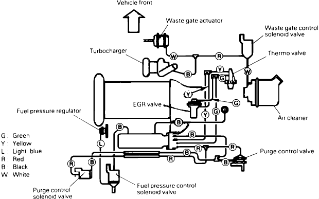

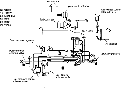

Emissions Control Vacuum Routing For Turbocharged California Vehicles
Emissions Control Vacuum Routing For Turbocharged Non-California Vehicles

Engine Compartment Harness Connections For Turbo Models
I/P Connector Locations

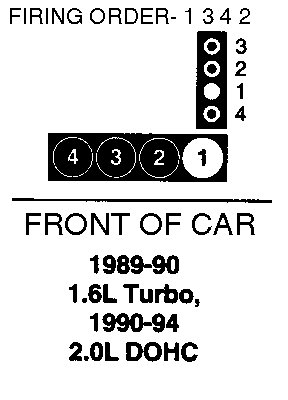

Ignition System Firing Order

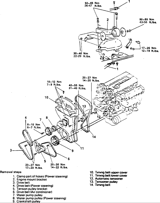

Timing Belt
Remove lower left engine compartment splash shield.
Support engine with engine support fixture, tool # C-4852 or # 7137, and remove the left engine mount and bracket Fig. 1.
NOTE:
Loosen water pump pulley bolts before removing belt.
Loosen the water pump pulley bolts. Remove the alternator/water pump drive belts, and the power steering drive belt.
Remove water pump pulley.
Remove the tensioner pulley bracket and the A/C belt.
Remove crankshaft pulley.
Remove the upper and lower timing belt covers.

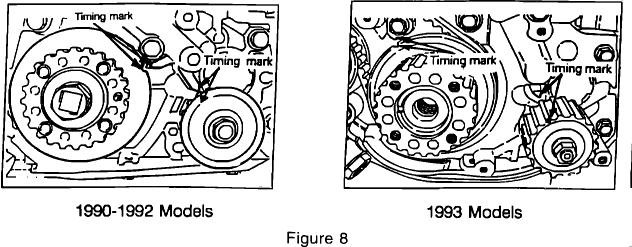

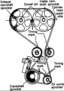

Rotate the crankshaft clockwise and align the timing marks so as to bring the No. 1 piston to the Top-Dead-Center (TDC) position of the compression stroke.
Caution:
Rotate the crankshaft in a clockwise direction.
The camshaft sprocket dowel pins must be at the 12 o'clock position and the camshaft sprocket timing marks must be aligned together (left sprocket at the 3 o'clock and right sprocket at the 9 o'clock positions). Both camshaft sprocket timing marks must be in line with the top surface of the cylinder head Fig. 54. [A straight edge (ruler) laid across the center of the camshaft attaching bolts will help you to better see and align the timing marks.] The crankshaft and oil pump sprockets must also be aligned with their respective timing marks Fig. 54.
NOTE:
CRANKSHAFT MAY NEED TO BE ROTATED UP TO SIX TURNS BEFORE ALL SPROCKETS ARE PROPERLY ALIGNED AND THE REAR BALANCE SHAFT IS IN PHASE, DUE TO THE OIL PUMP - TO BALANCE SHAFT GEAR RATIO.

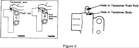

Compress the Auto Tensioner push rod by SLOWLY rotating special tool no. MD998738 until hole in Auto Tensioner push rod aligns with the hole in the Auto Tensioner body Fig. 5.
NOTE:
PUSH ROD MAY NEED TO BE ROTATED IF HOLE IN ROD IS NOT VERTICALLY IN LINE WITH HOLE IN HOUSING.
Insert a 1/16 inch allen wrench or similar pin (1.4 mm (.055 in.) in diameter) into the aligned holes to hold the push rod in the reset (pinned) position. Back off special tool MD998738 once auto tensioner is in the reset position Fig. 5.
NOTE:
INSPECT THE TENSIONER AND REPLACE IT IF IT SHOWS SIGNS OF OIL LEAKAGE.

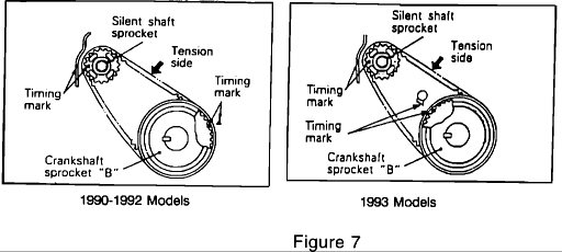

Installation of Timing Belt "B"
Ensure that the crankshaft sprocket and the silent shaft sprocket timing marks are aligned. Install new timing belt "B" over crankshaft sprocket "B", around the tensioner pulley, and over the silent shaft sprocket. Do not leave any slack on the tension side of the belt Fig. 7.
Push the timing belt "B" tensioner up to place pressure on the timing belt so that the tension side is taut. Belt tension should be 5-7 mm (.20-.28 in.) using the belt deflection method. Tighten the tensioner center bolt and torque to 15-22 Nm (11-16 ft.lbs.) Fig. 7.
CAUTION:
WHEN TIGHTENING THE BOLT, ENSURE THAT THE TENSIONER PULLEY SHAFT DOES NOT ROTATE WITH THE BOLT. ALLOWING IT TO ROTATE CAN CAUSE EXCESSIVE TENSION ON THE BELT.

Make sure the camshaft sprocket dowel pins are located at the 12 o'clock position and the camshaft sprocket timing marks are aligned together (left sprocket at the 3 o'clock and right sprocket at the 9 o'clock positions). Both camshaft sprocket timing marks should be in line with the top surface of the cylinder head Fig. 54.
NOTE:
THE EXHAUST CAMSHAFT SPROCKET MAY ROTATE IN THE COUNTERCLOCKWISE DIRECTION. THIS SHOULD BE CONSIDERED WHEN INSTALLING THE TIMING BELT.
Make sure that the crankshaft sprocket and the oil pump sprocket is aligned with the timing mark pointers Fig. 8.
Remove the balance shaft plug on the rear side of the cylinder block and insert a Phillips screwdriver (shank diameter 8 mm (.31 in.)) through the hole. The balance shaft is in the correct position if the screwdriver can be inserted at least 60 mm (2.4 in.). If the inserted depth is less than this, only 20-25 mm (.8-1.0 in.), the oil pump sprocket must be rotated one full turn and timing marks realigned. Recheck the balance shaft position using the screwdriver to ensure that it can be inserted 60 mm (2.4 in.) or more. Keep the screwdriver inserted until timing belt installation is complete Fig. 9.
CAUTION:
MAKE SURE THE BALANCE SHAFT IS PROPERLY POSITIONED. It is possible for the oil pump sprocket timing marks to be properly aligned, and have the balance shaft out of phase. This could result in a SEVERE engine vibration.
Install the new timing belt over the intake side camshaft sprocket and clamp it in position with a clip Fig. 10.
Use a wrench to maintain alignment of the two camshafts and install the timing belt over the exhaust side sprocket, aligning the timing marks as shown in Figure 2 and clamp the belt in position with a clip Fig. 11 & 12.
Position the timing belt around the idler pulley, oil pump sprocket, crankshaft sprocket and tensioner pulley (in that order) as shown in Fig. 13.

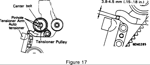

Loosen the tensioner pulley center bolt, attach special tool no. MD998767 (or MD998752) and apply2.7 Nm (24 in.lbs.) torque to pulley (with beam type torque wrench) as shown in Fig. 15. WITH TORQUE APPLIED TO THE TENSIONER PULLEY, tighten the attaching bolt, then torque to49 +/- 6 Nm (36 +/- 4 ft.lbs.).
Caution:
Failure to follow this procedure will cause the belt tension to exceed the range of the auto tensioner limits and result in premature timing belt failure or jumping.
NOTE:
IF THE VEHICLE BODY INTERFERES WITH THE SPECIAL TOOL AND THE TORQUE WRENCH, RAISE THE ENGINE UP SLIGHTLY UNTIL THERE IS ADEQUATE CLEARANCE.
SLOWLY rotate the special tool no. MD998738 until it makes contact with the tensioner arm and remove the allen wrench from the auto tensioner Fig. 16.
Back off the special tool and rotate the crankshaft SIX complete turns clockwise.
Measure the auto tensioner push rod position with a drill bit (distance between the tensioner arm and auto tensioner body) to ensure that it falls within the specification of 3.8-4.5 mm (.15-.18 in.) as shown in Fig. 17.
NOTE:
WAIT 15 MINUTES AFTER THE ALLEN WRENCH IS REMOVED FROM AUTO TENSIONER (FOR PLUNGER ROD TO STABILIZE) BEFORE MEASURING. IF THE PLUNGER ROD IS OUT OF SPECIFICATION, RESET THE AUTO TENSIONER (STEPS 10, 11 AND 12) AND REPEAT STEPS 29 THROUGH 32 UNTIL THE SPECIFIED VALUE IS OBTAINED.
Remove special tool no. MD998738 and install the rubber plug to the inner timing belt cover.

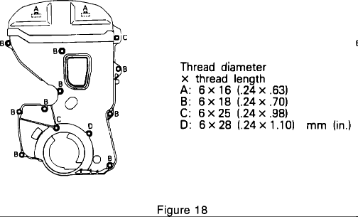

Install the upper and lower timing belt covers as shown in Fig. 18. (Rotate the bottom of the lower cover toward the rear to assist in clearing the water pump).
NOTE:
THE TIMING COVER BOLTS VARY IN LENGTH. MAKE SURE THAT THE PROPER SIZE BOLTS ARE INSTALLED IN THE CORRECT HOLE LOCATIONS Fig. 18.

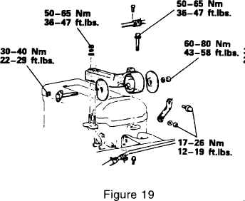

Install left front engine mount and bracket and torque to the specifications shown in Fig. 19.

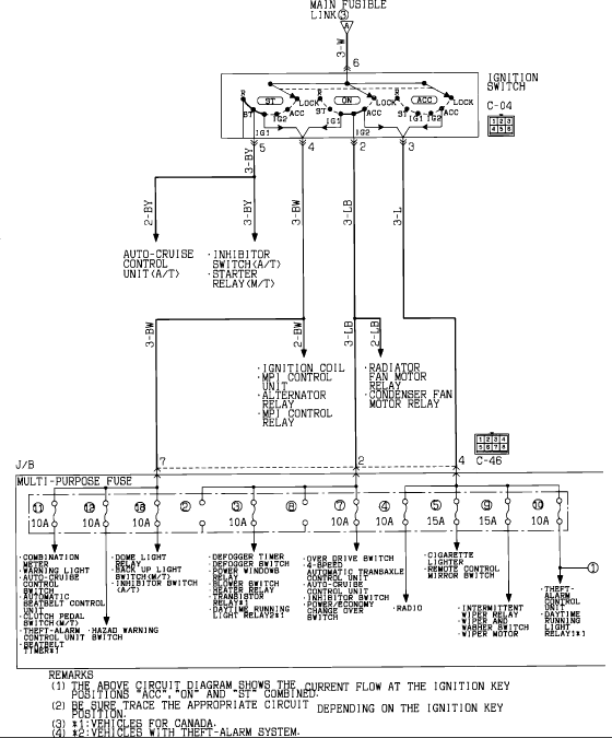

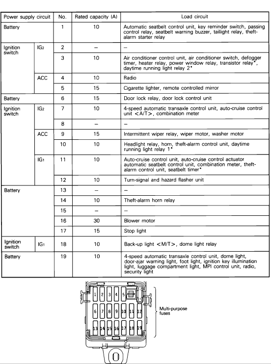

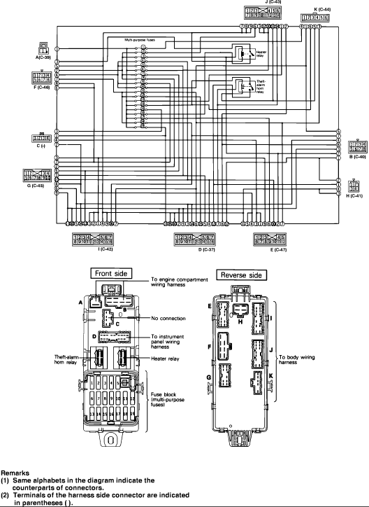

Fuse Panel Details

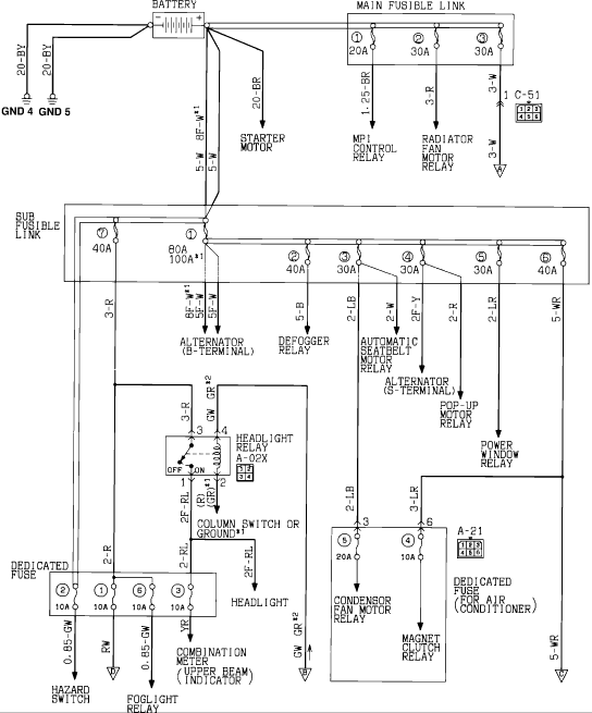

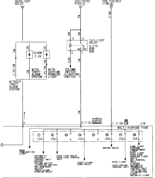

Power Distribution

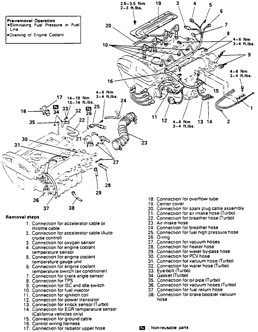

Cylinder Head Removal
Remove cylinder head in numbered sequence, Fig. 20, noting the following:
Before disconnecting high pressure fuel line, relieve fuel system pressure as follows:
Disconnect fuel pump harness connector at fuel tank.
Start engine and let it run until it stalls, then turn ignition switch to off.
Disconnect negative battery cable.
Reconnect fuel pump harness connector.
Cover fuel line connection with rags to prevent spraying of fuel during disconnection.
Before removing upper radiator hose, mark hose clamp in relation to hose for assembly reference, then drain coolant as follows:
Place instrument panel temperature control lever in Hot position.
Carefully remove radiator cap.
Remove radiator drain plug.
Refer to TIMING BELT when removing timing belt.
Using cylinder head bolt wrench No. MD998051 or equivalent, remove cylinder head bolts in sequence as shown in Fig. 21.
INSTALLATION
Reverse removal procedure to install, noting the following:
Install cylinder head gasket as follows:
Using a suitable scraper, remove old gasket material from cylinder block, using care not to allow old gasket material to fall into cylinder or passages.
Clean head and block surfaces that come in contact with head gasket.
Place head gasket on block with identification mark at top front. Do not apply sealant to head gasket.
Fig. 22 Head Bolt Tightening
Head Torque sequence
When installing cylinder head, install head bolt washers, then torque head bolts to 65-72 ft.lbs.(90-100 Nm) in two or three steps and in order as shown in Fig. 22.
When installing semi-circular packing, apply liberal amount of gasket sealant onto circumference of packing.
When installing rocker cover, apply gasket sealant to area as shown in Fig. 23.
Refer to TIMING BELT when installing timing belt.
When installing high pressure fuel line (5), apply small amount of gasoline to hose union. Use care to avoid damaging O-ring.

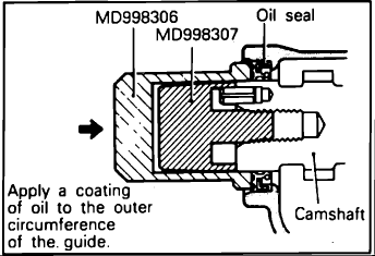

Installing Camshaft Oil Seal.
When installing camshaft oil seal, use oil seal guide tool No. MD998307 and oil seal installation tool No. MD998306 or equivalents as shown, Fig. 69.

Before installing pistons and connecting rod assemblies into the bore, be sure that compression ring gaps are staggered so that neither is in line with oil ring rail gap.
Before installing the ring compressor, make sure the oil ring expander ends are butted and the rail gaps
Immerse the piston head and rings in clean engine oil, slide the ring compressor, over the piston. Be sure position of rings does not change during this operation.

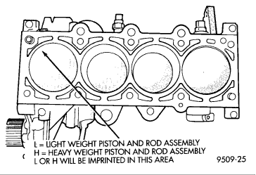

The weight stamp designation L for light or H for heavy assembly will be in the front half of the piston facing toward the front of the engine.
Rotate crankshaft so that the connecting rod journal is on the center of the cylinder bore. Insert rod and piston assembly into cylinder bore and guide rod over the crankshaft journal.
Tap the piston down in cylinder bore, using a hammer handle. At the same time, guide connecting rod into position on connecting rod journal.
Install rod caps. Install cleaned and oiled rod bolts and tighten to 27 Nm (20 ft. lb.) Plus 1/4 turn.
CONNECTING RODS
See main bearing for measureing and specifiction procedures.
CAUTION: Do not rotate crankshaft or the Plastigage may be smeared. The rod bearing bolts should not be reused.
Before installing the NEW bolts the threads should be oiled with clean engine oil.
Install each bolt finger tight than alternately torque each bolt to assemble the cap properly.
Tighten the bolts to 27 Nm PLUS 1/4 turn (20 ft. lbs. PLUS 1/4 turn) Do not use a torque wrench for last step.
Using a feeler gauge, check connecting rod side clearance.

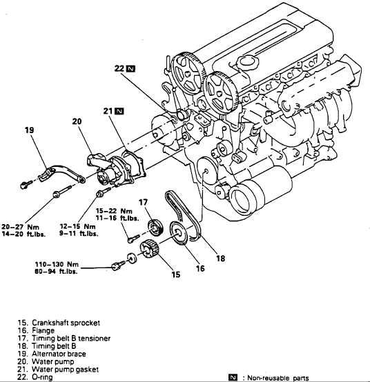

Water Pump Assembly
REMOVAL
Remove water pump in numbered sequence, Fig. 77, noting the following:
Remove lower engine compartment cover.
Drain engine coolant as follows:
To remove engine mount bracket, slightly raise and support engine, removing weight of engine from mount.
Remove automatic tensioner, timing belt and timing belt B, refer to TIMING BELT .
Fig. 78 Water Pump Attaching Bolts.
INSTALLATION
Coat the O-ring (26) with water to ease installation.
Refer to bolt length chart, Fig. 78, when installing water pump attaching bolts.

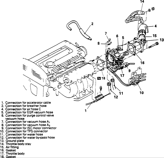

Throttle Body
