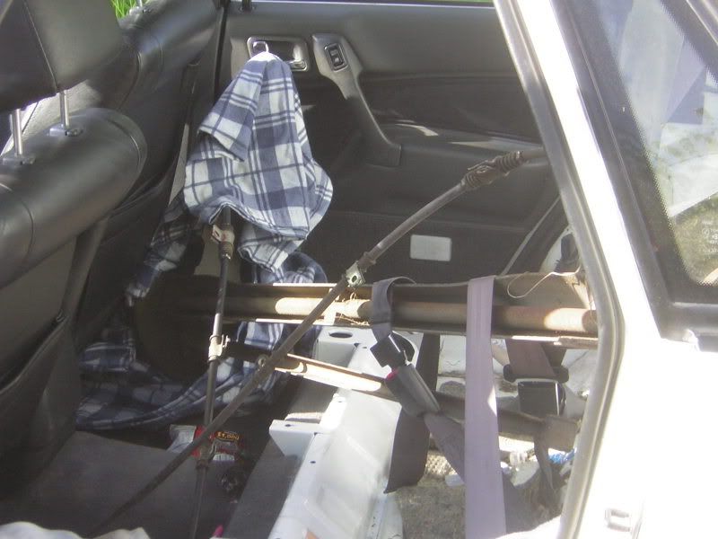

Glory shot, CSM turbo axle in the back of your VR-4. ingenious or insane?
~joe
Rear seat delete! Well, rear seat into the trunk mod :)
