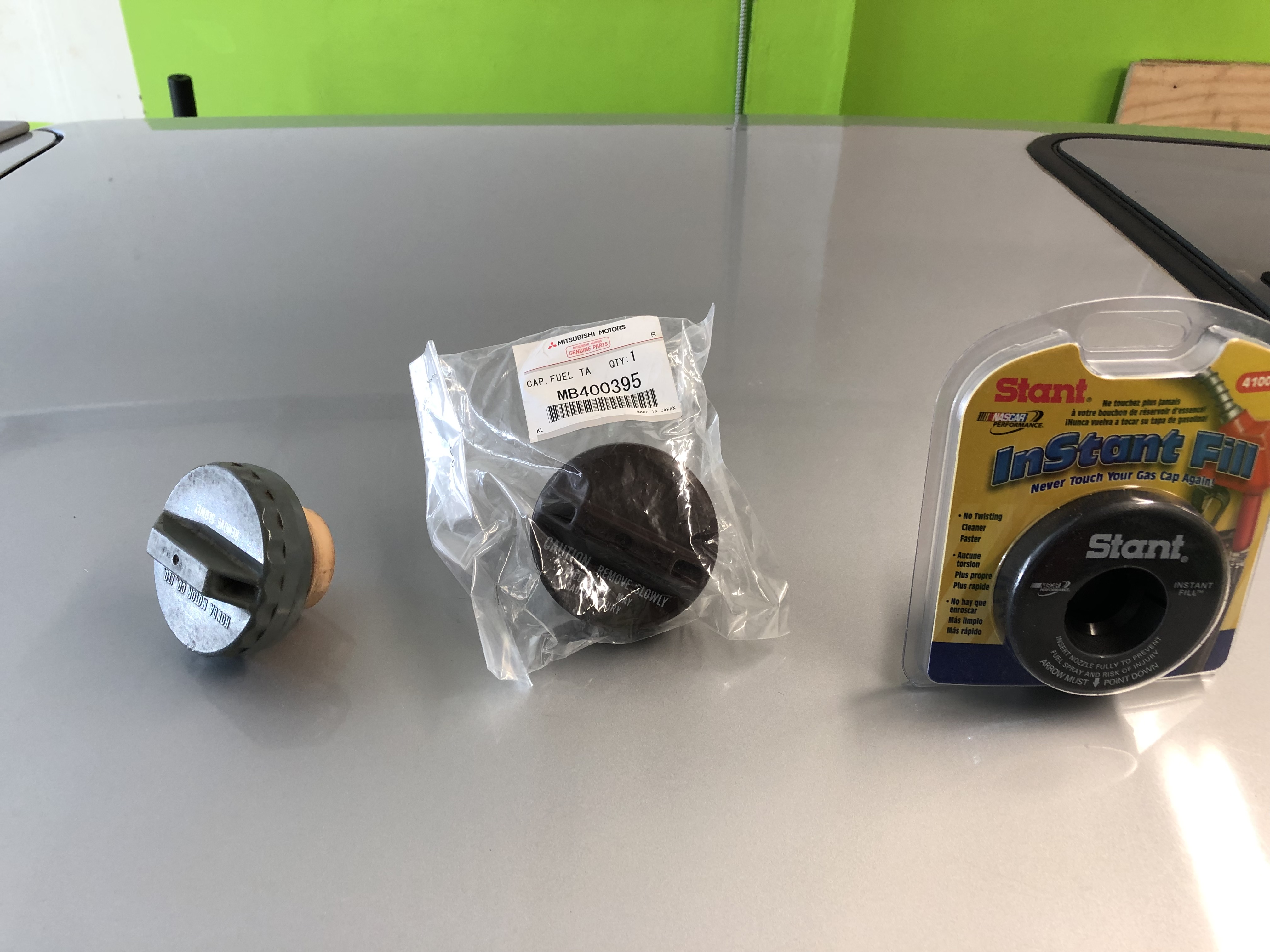

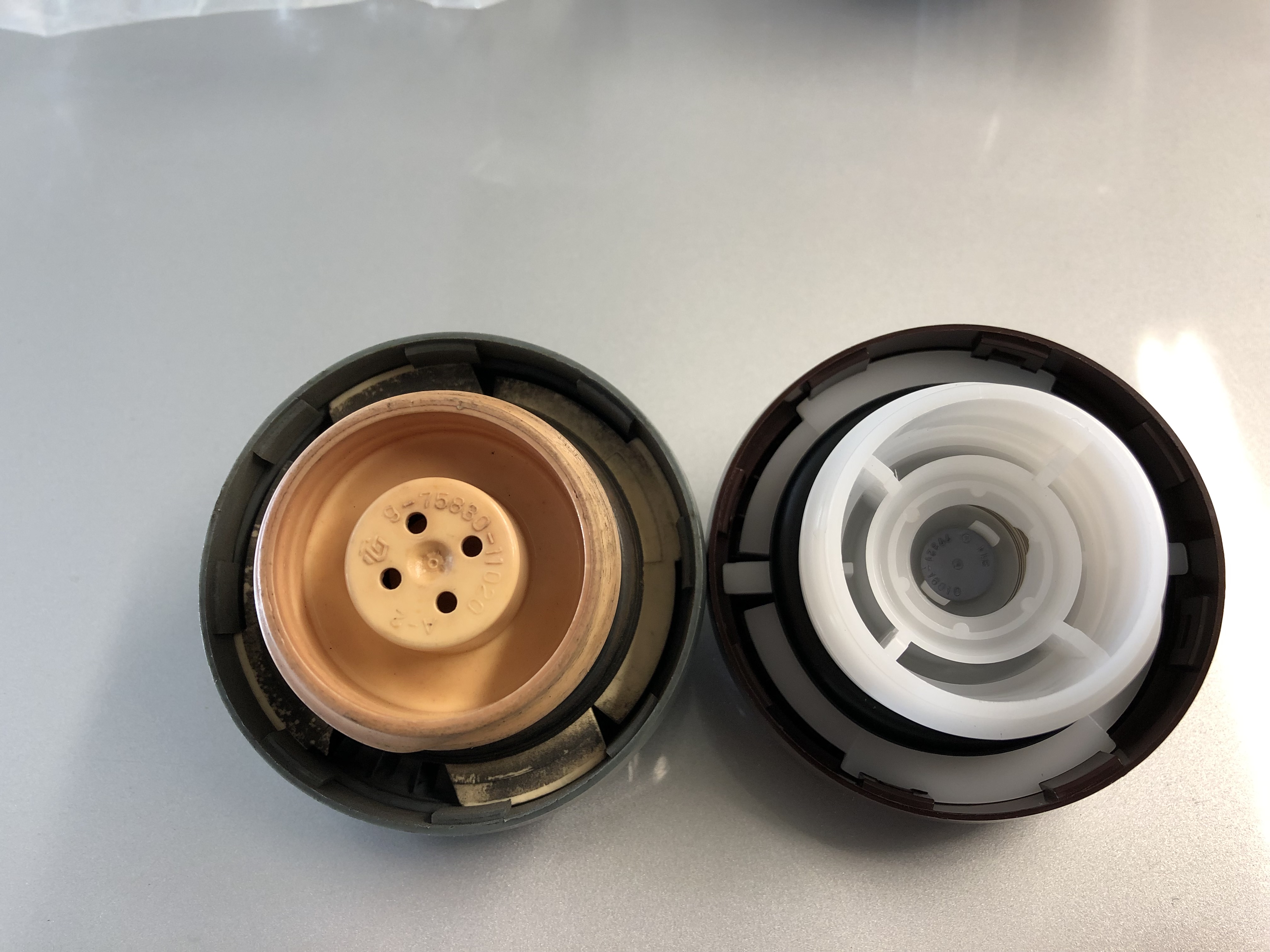

So, was it fuel related? Some suggested so, and I put on a new OEM cap to make sure that venting function, does exist and no suction was created in the tank system when warm/hot from sitting on a hot day.
I have a new spare gas cap which is a cap-less style as it is called, so the nozzle goes right in the cap, and opens a little flap door - nothing more than that.

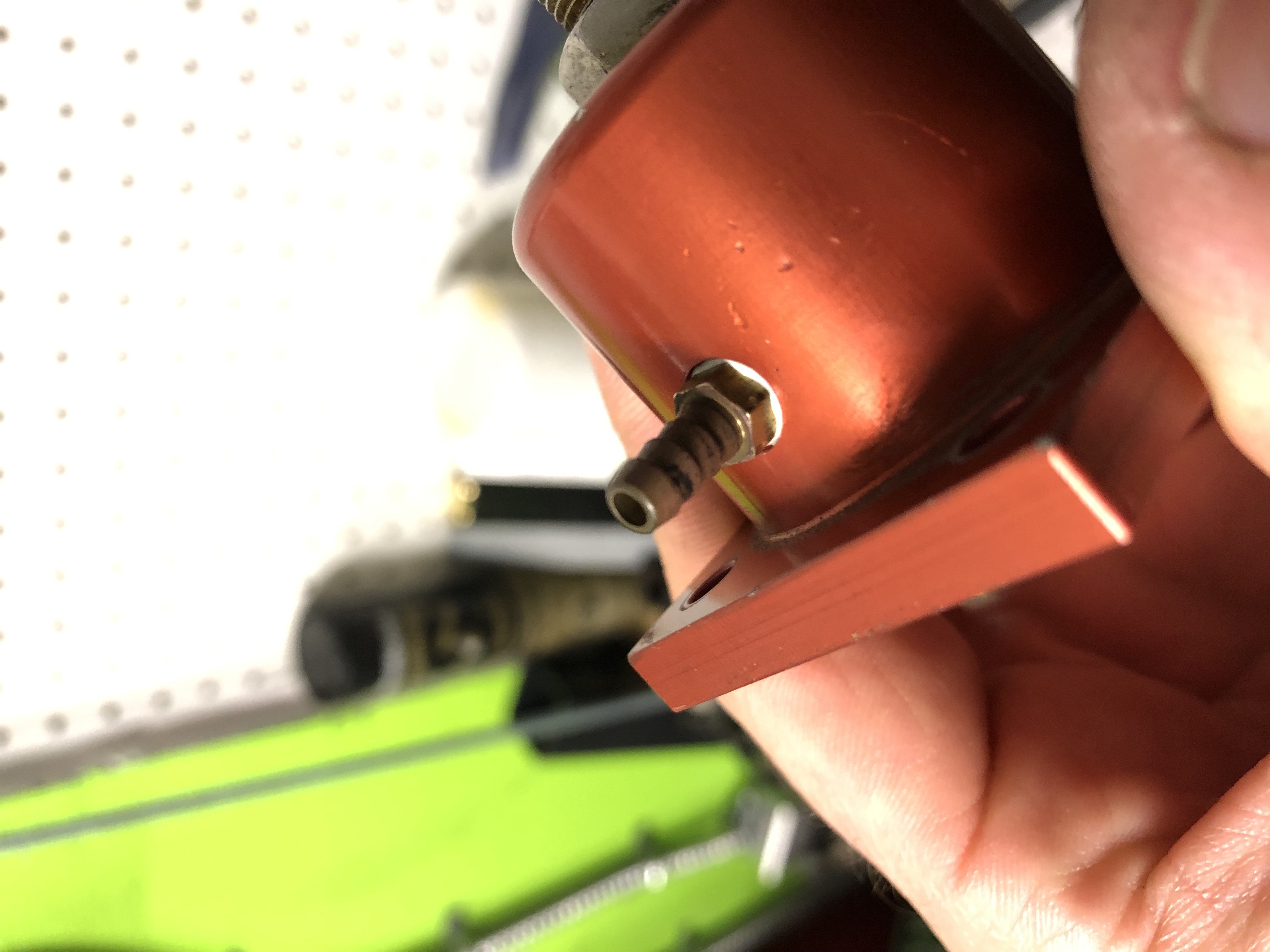

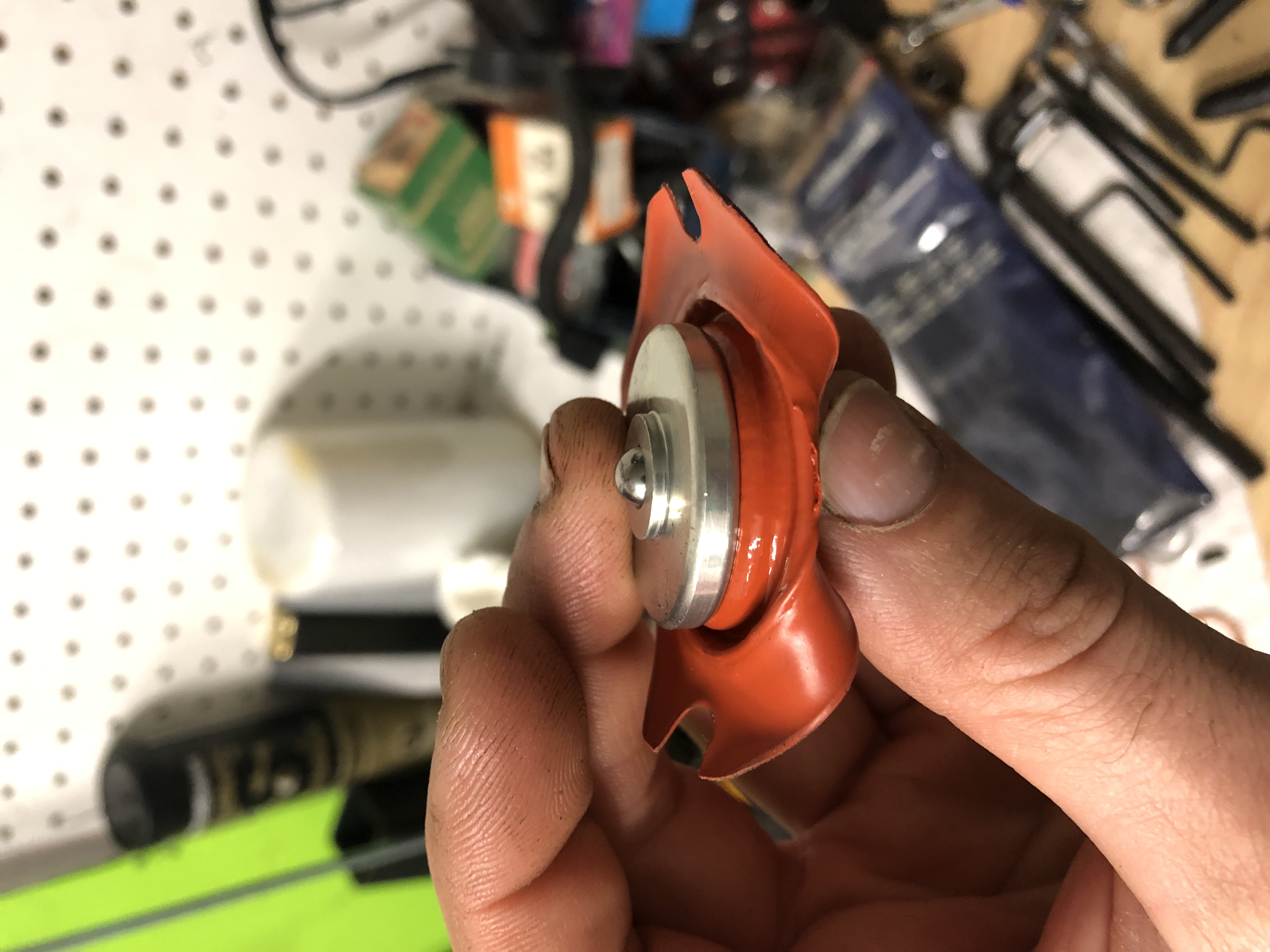

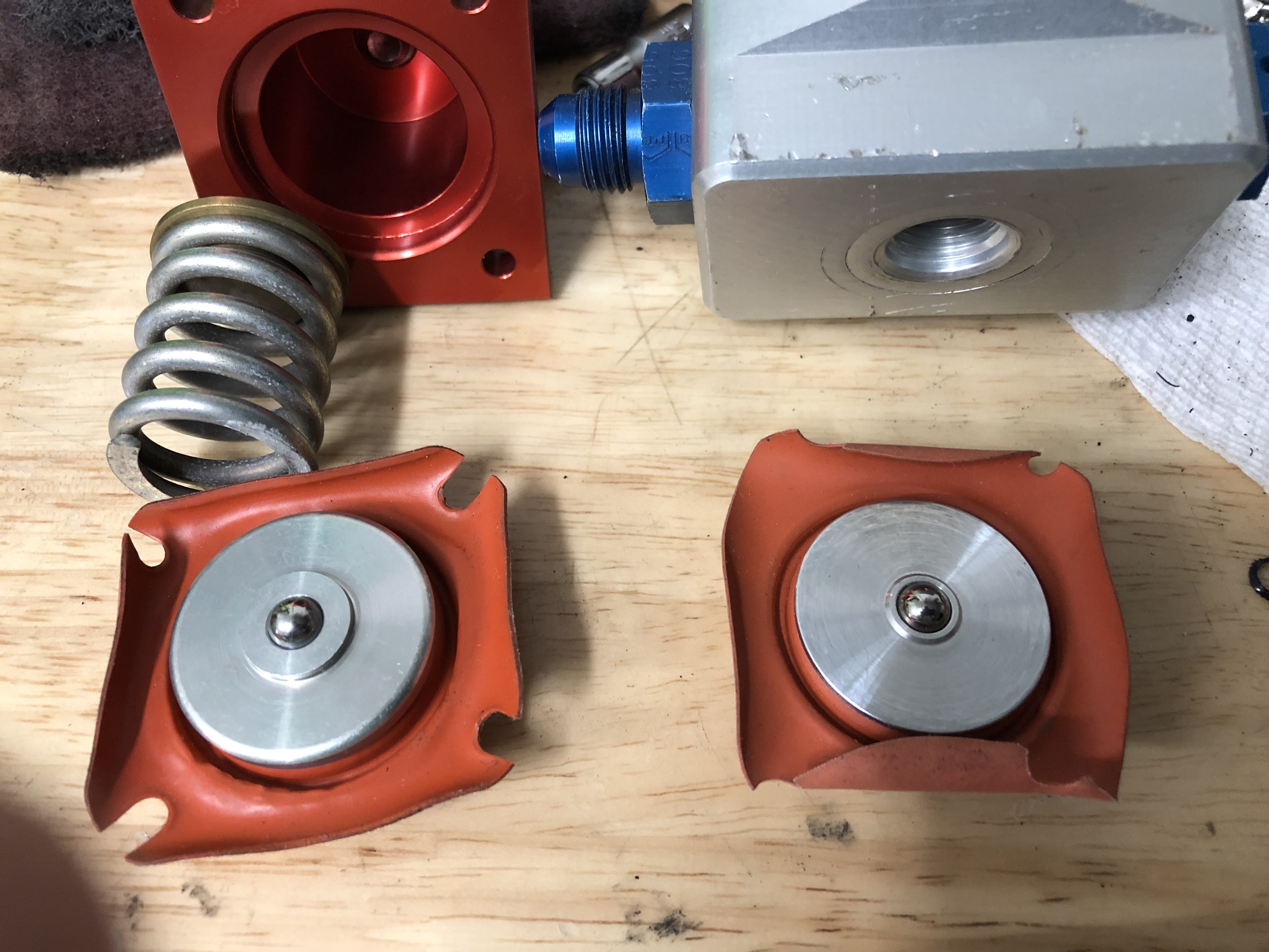

Decided to open my SX Performance/Buschur Racing style AFPR. Diaphragm torn on one side, fuel bubble popped as the vacuum hose was drawn off the vacuum nipple, and more fuel evident in the cap area where atmostphere alone, is supposed to be.
Backstory to the SX/Buschur AFPR - it is a bolt on affair. Nothing simpler by design - one o-ring at the rail, and some parts inside the FPR to balance and keep things separated. Turns out the no longer produced top SX portion with the bottom section Buschur part (produced by ... see tuners thread on this one), had a new lease on life. Edelbrock was reported to have purchased SX Performance and as such are offering replacement diaphragm/FPR kits. Parts were listed in a thread on Tuners. I found the part numbers and link from Tuners, and was offered on Jegs.com and summitracing.com to name a few. SX performance may still have the parts too as the OEM number in house for them was also listed in that thread.

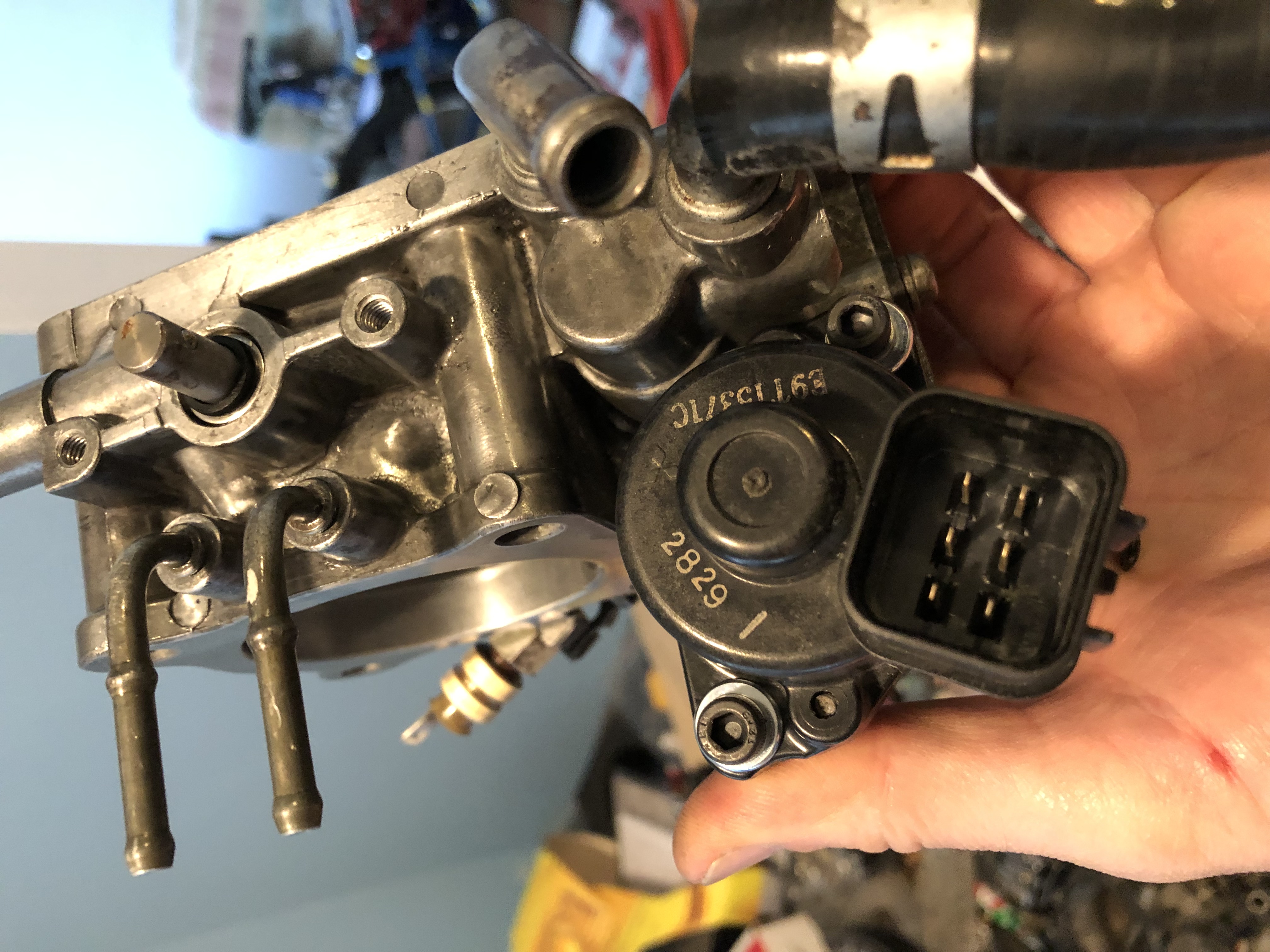

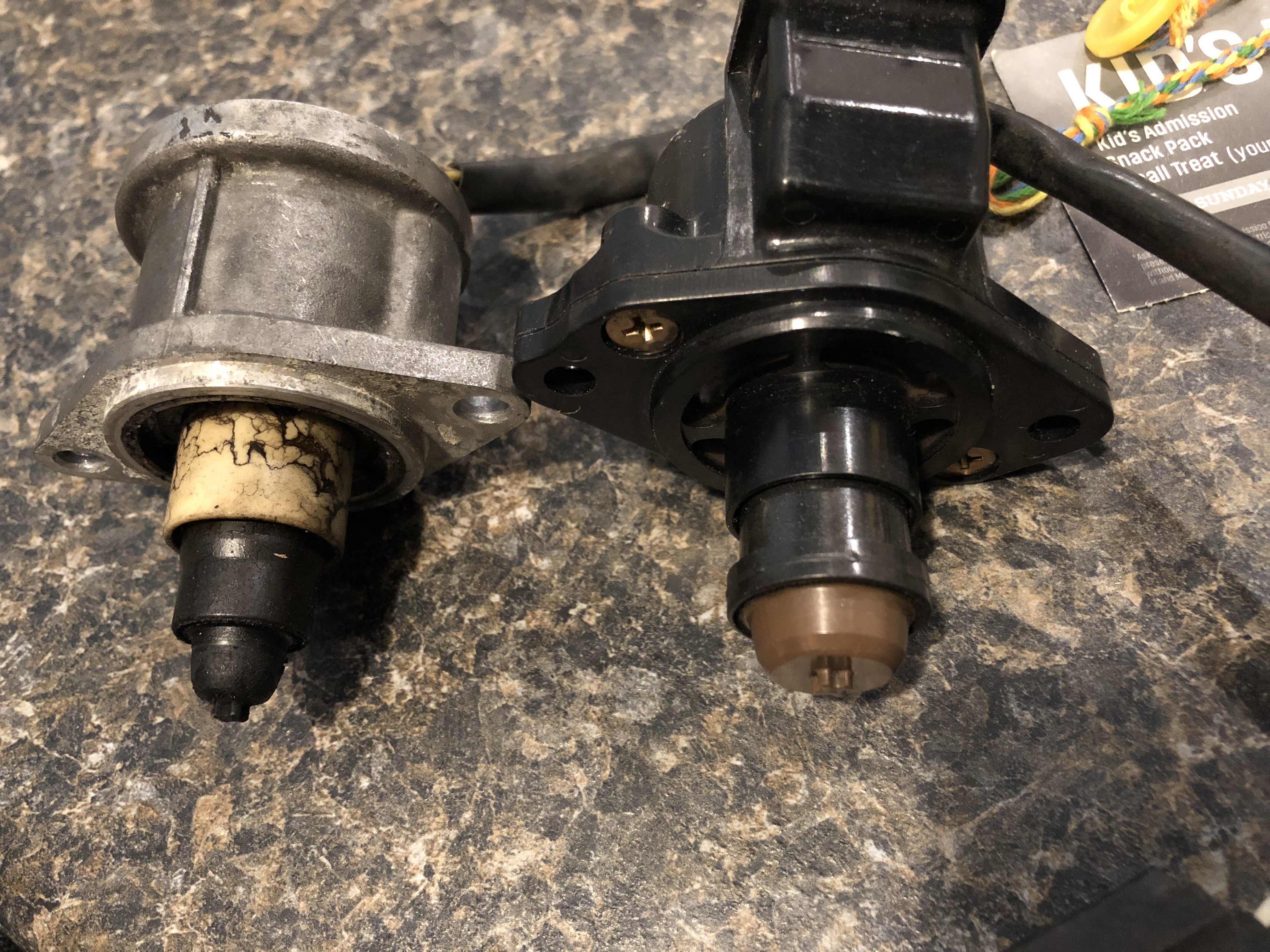

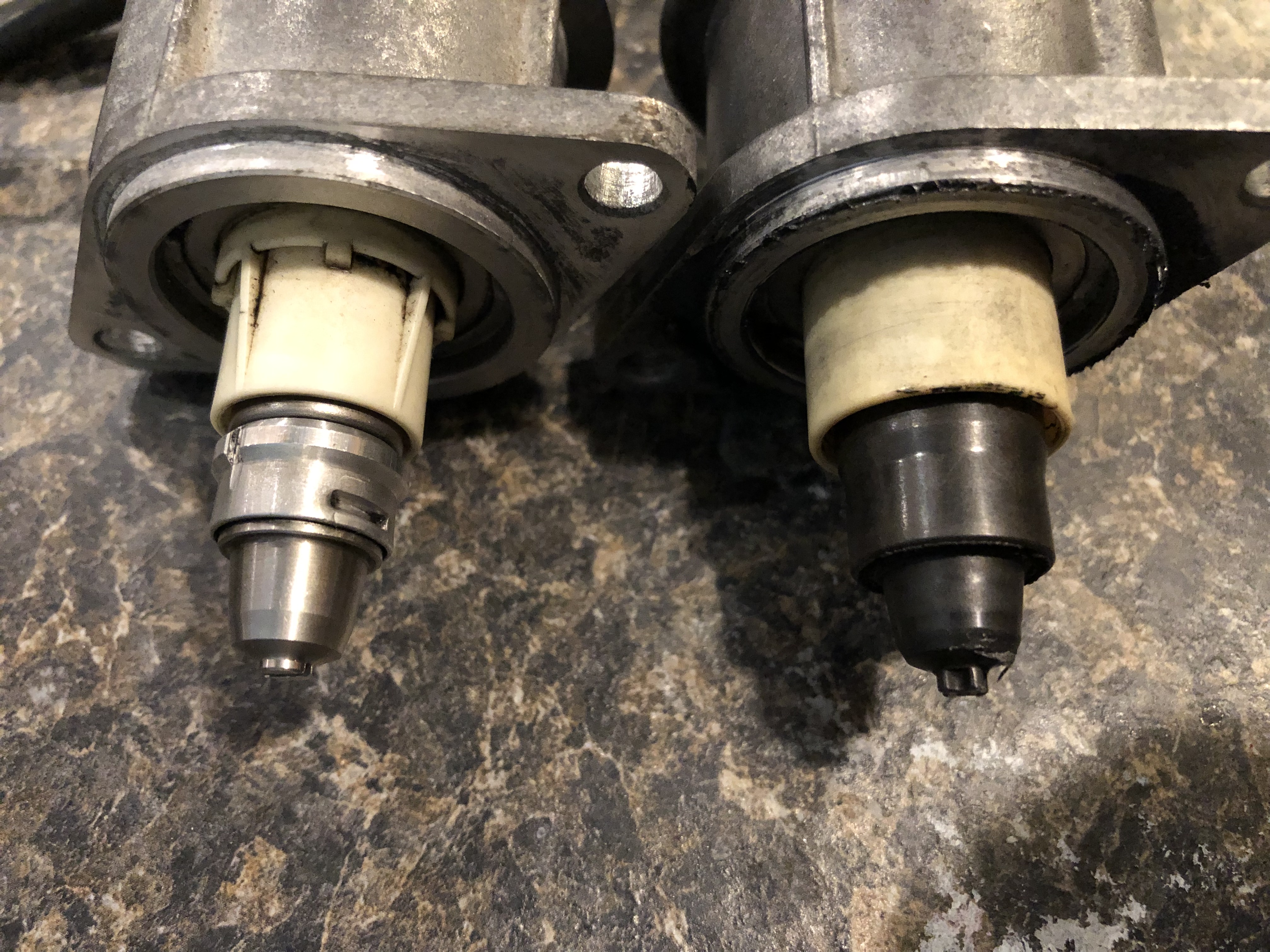

Pics. The ISC show was the wrong type, in that the tip not shown, was the wrong shape. It should have been skinny and long, versus the flat stub like one as shown from the other side.
I did install socket head bolts that allow access with allen wrenches or ball socket extensions for use with short ratchets. This was especially good for the TPS, and adjusting it without needing to find space for an 8mm wrench end or a JIC head screw driver (remember all Japanese cars of this era use JIC type bits, NOT Phillips!).

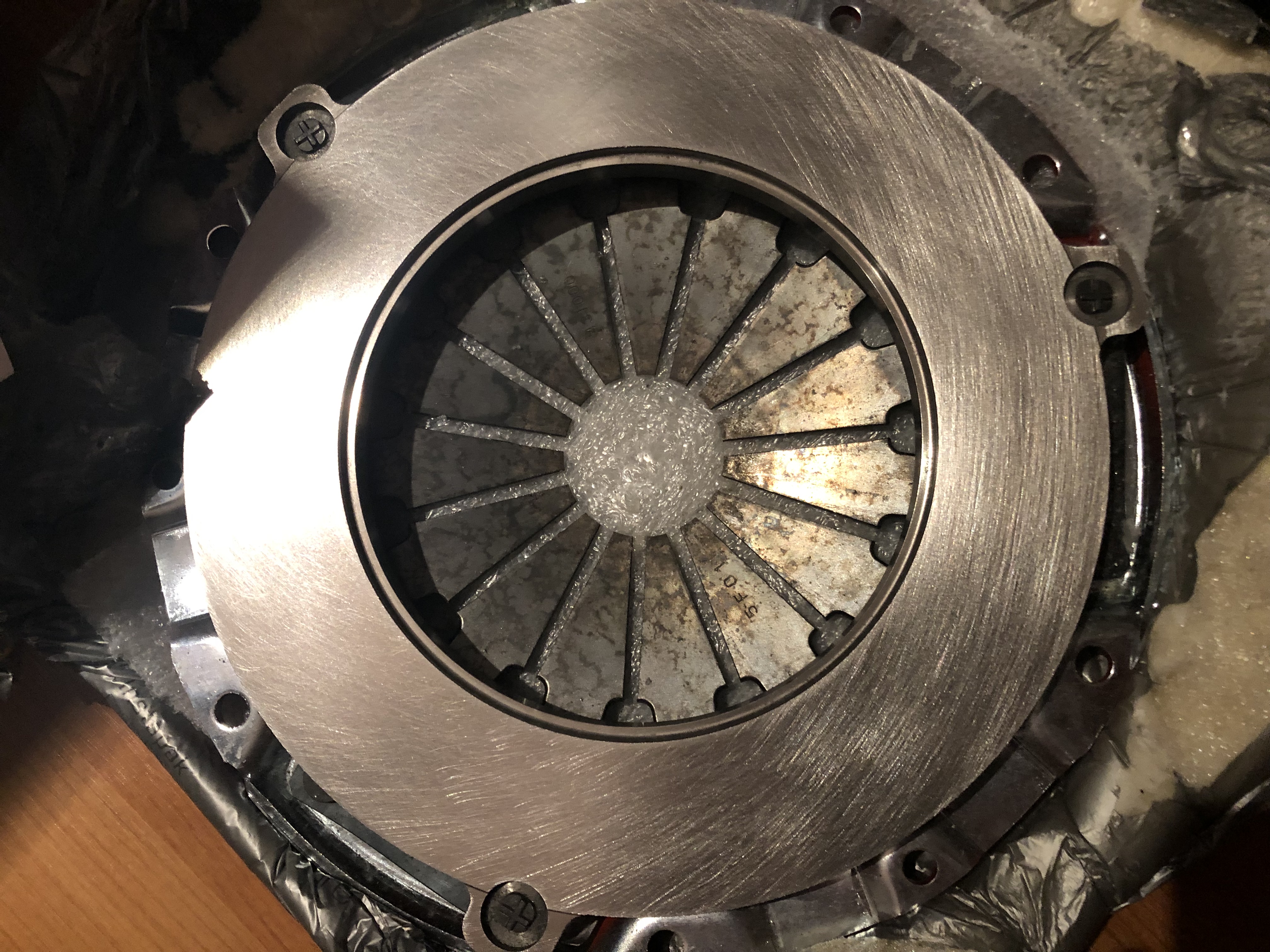

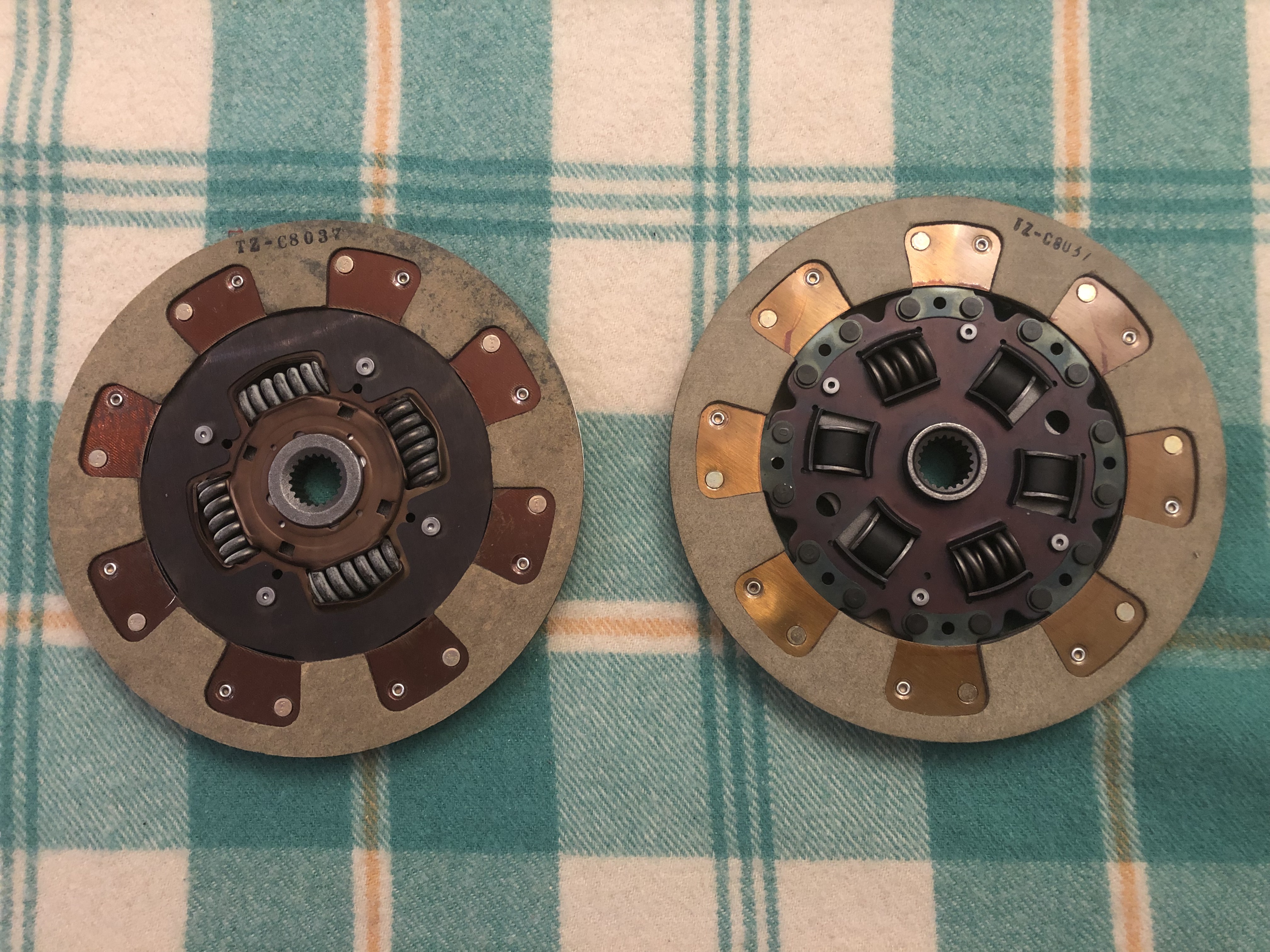

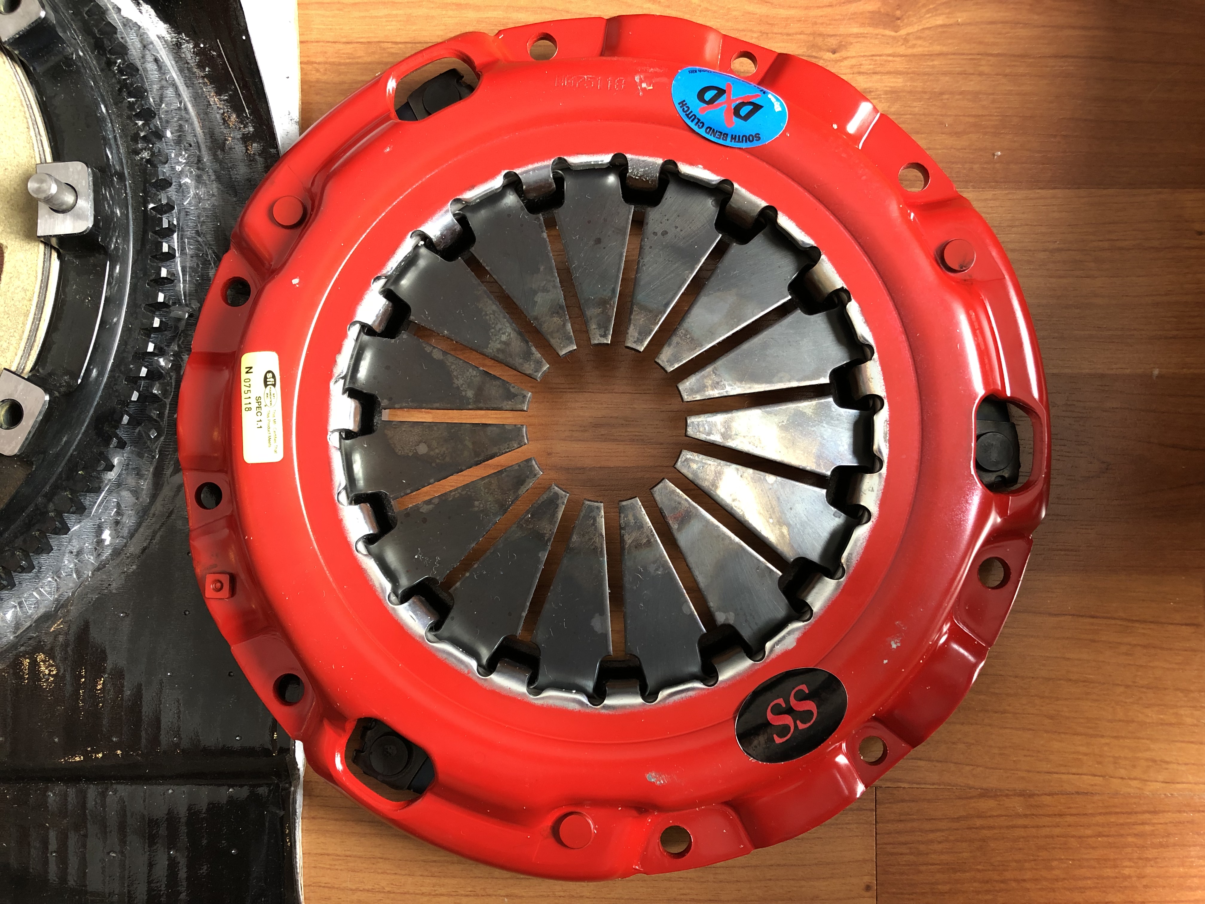

Shown would be my SBC kevlar clutch versus the same model that had issues with rivets stampings and even had the better Exedy center section, but unfortunately couldn't use that one. It had to go back to keep the one with no issues.

Flywheel before sanding to match Tim Zimmers recommendation for grit prep.

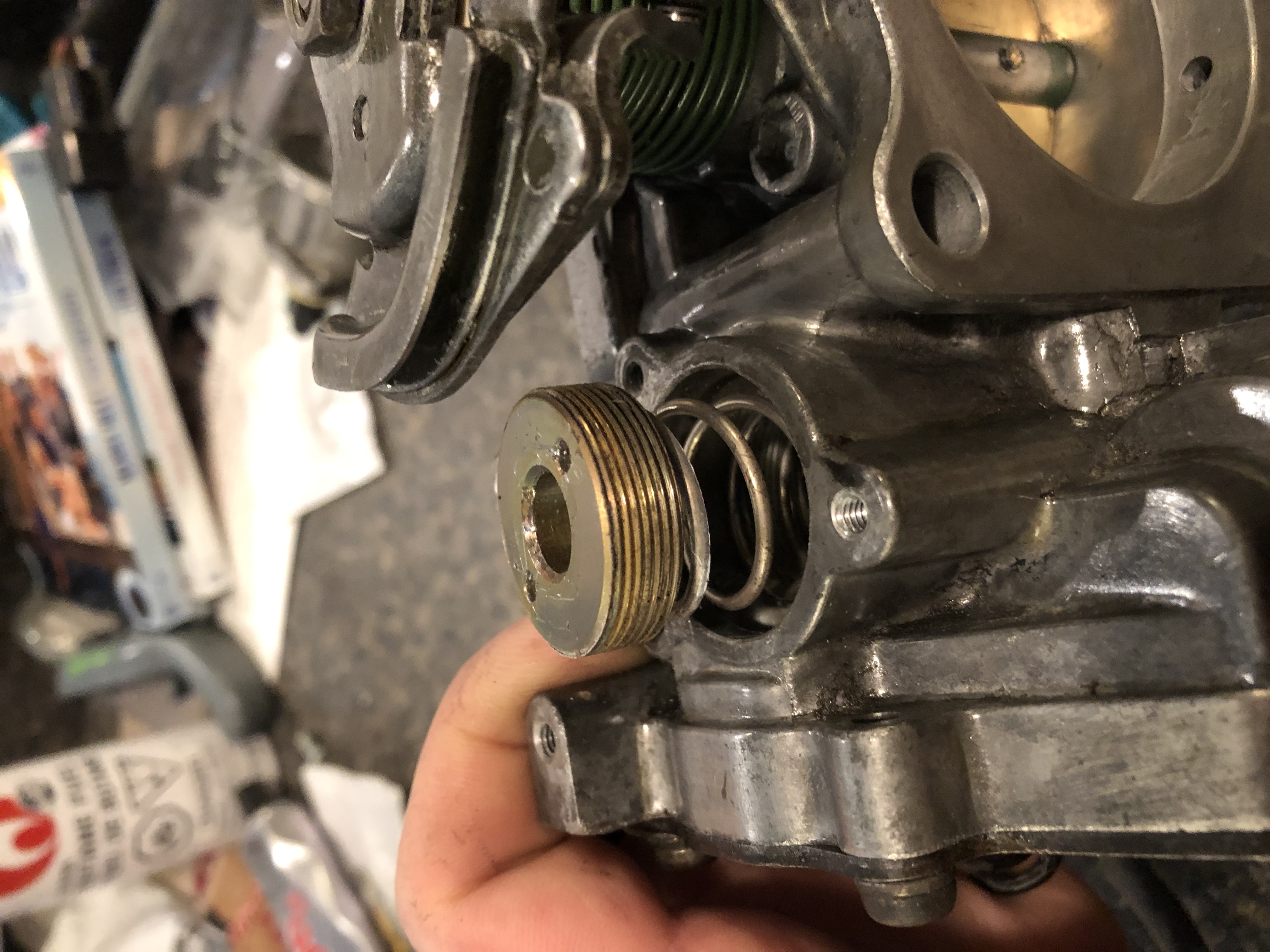

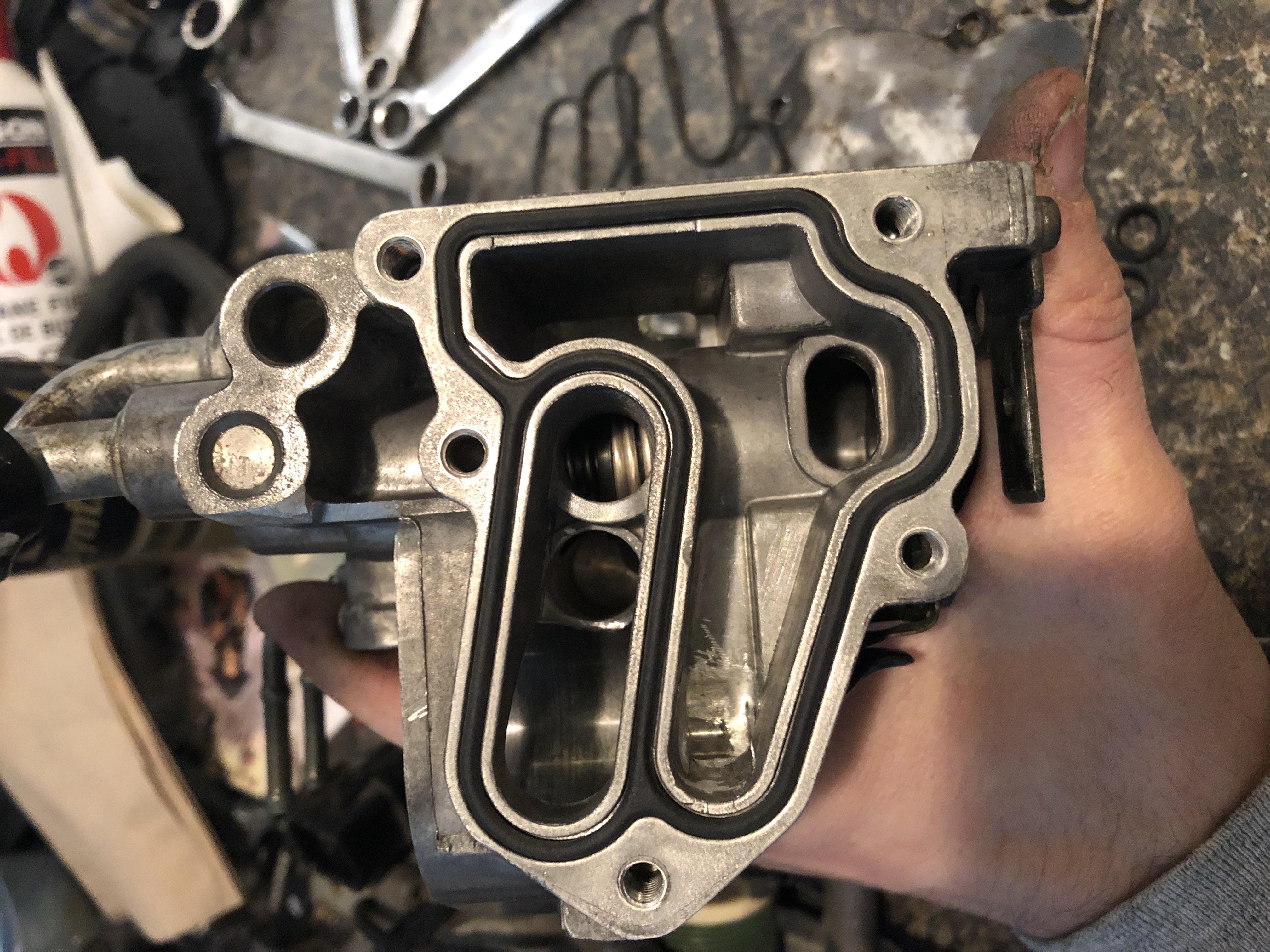

Removed and proved the FIAV was moving from freezer cold, to 90 C and up.
All channels cleaned and reinstalled FIAV cap and internals with blue loctite on the threads of the cap.
Cleaned up the OEM ISC as pictured with silver metal cap. Had at least on spare hanging around too ...

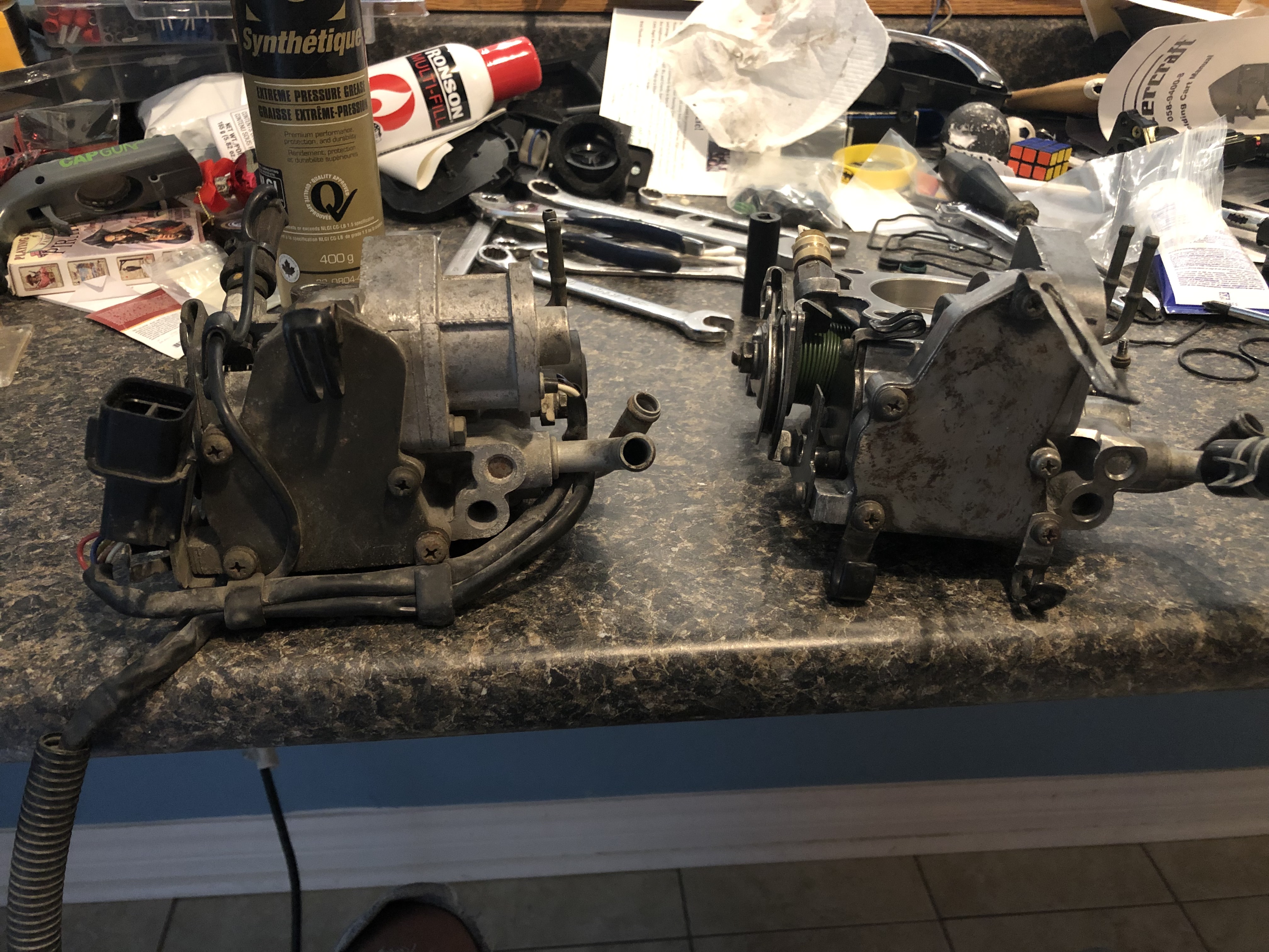

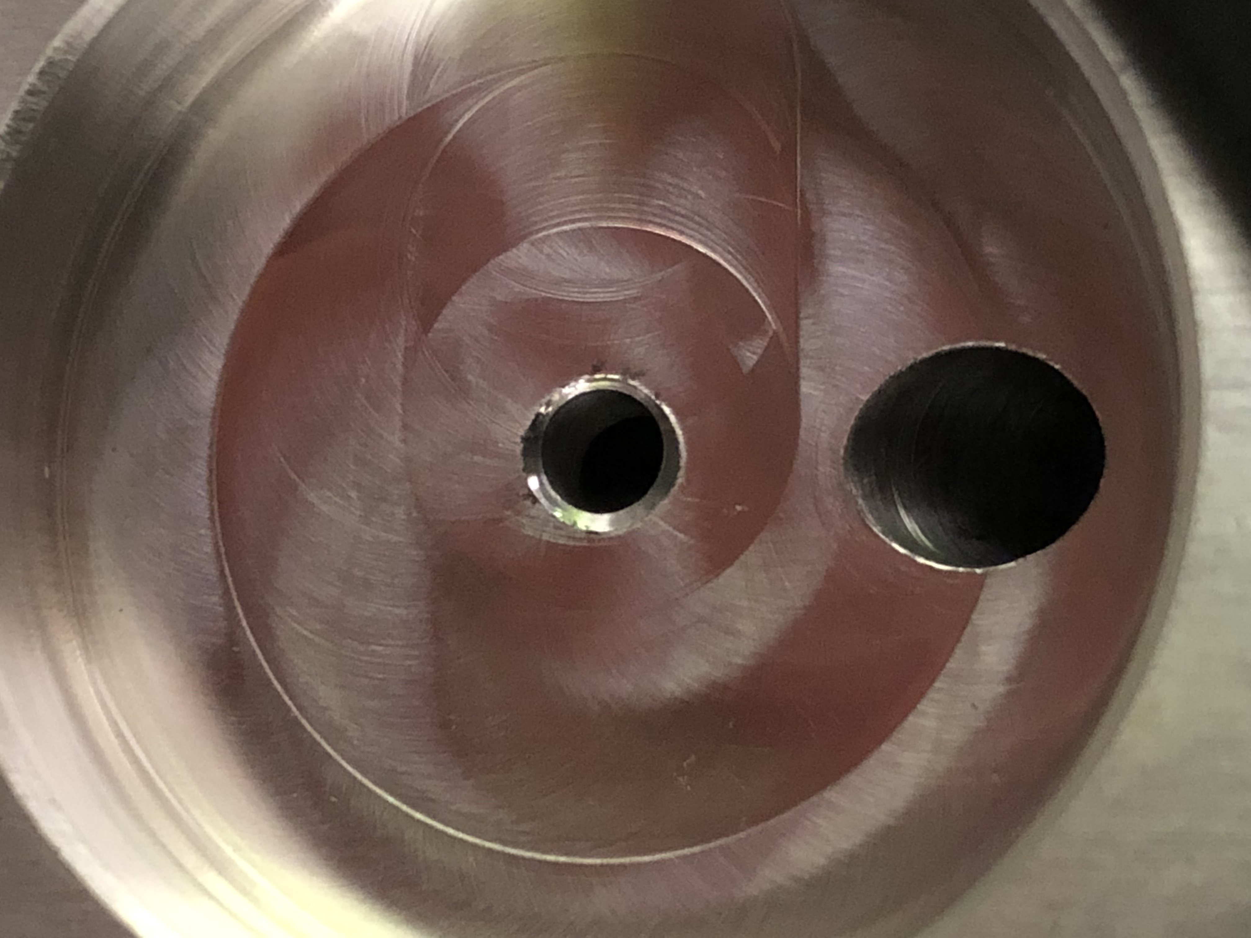

90 DSM 60mm turbo throttle body is identical to a 1989 Mitsubishi Mirage turbo throttle body. The only difference is in the bore or lack there of through the center, and the corresponding throttle blade/plate change to suit.

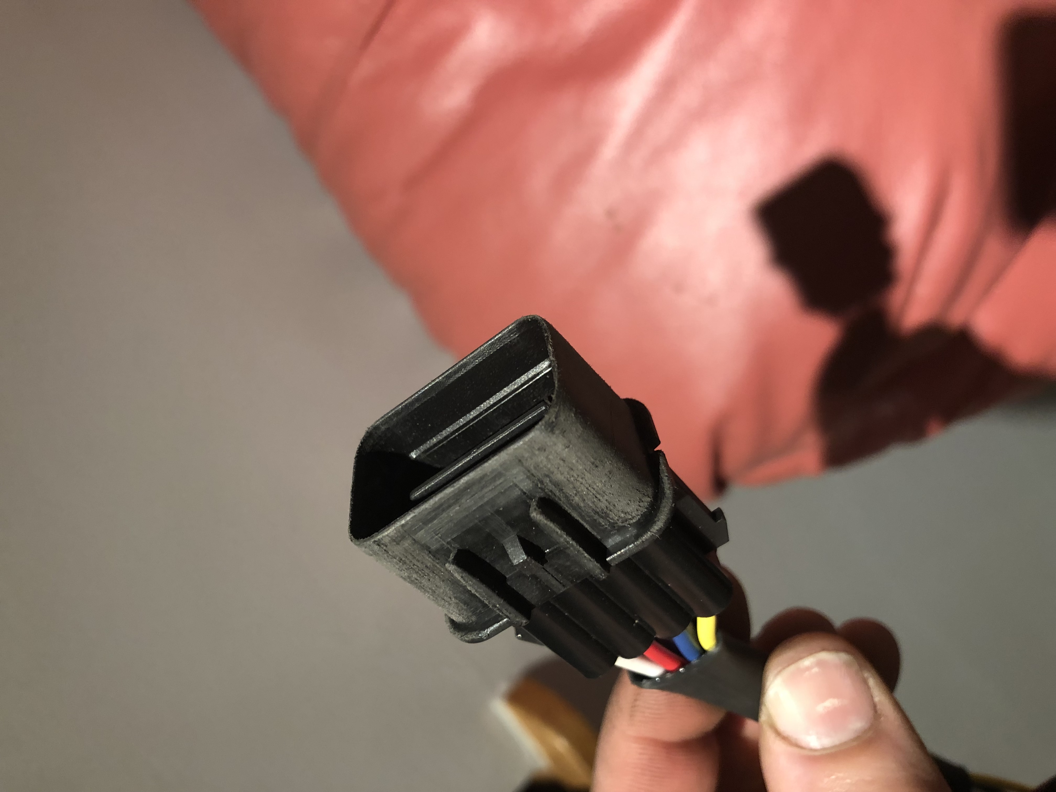

Should I ever install a newer updated ISC, I would be asking the company that made this adapter to check out their connector stock, as I had to sand and file the ever loving jebus out of those areas that came into contact with the OEM connectors, in the worst way. It works as it should now, but the plastic was bowed out considerably and all around.

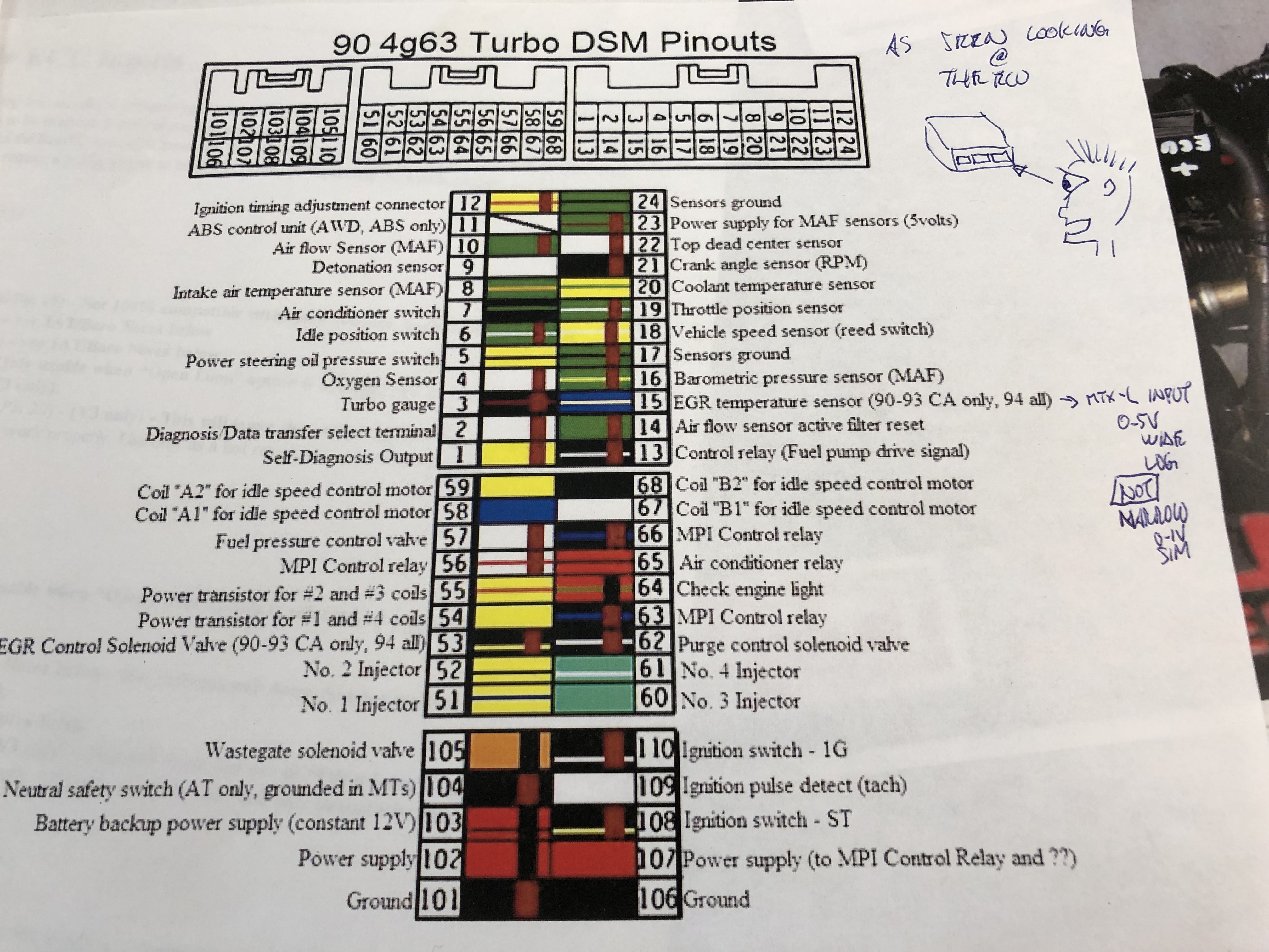

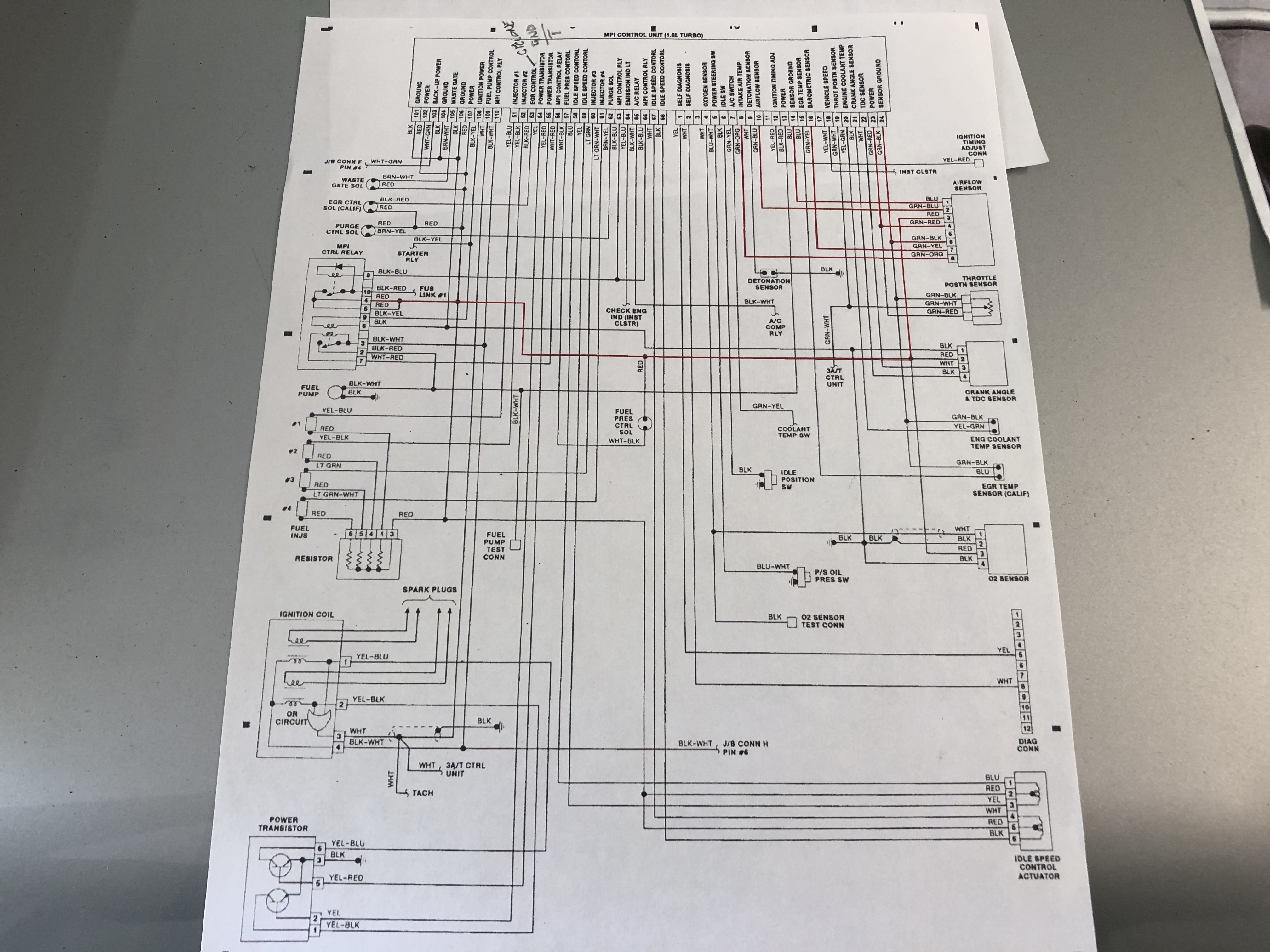

How my system is configured, wire locations, etc. Remember that 1989 Mirage Turbo wiring is identical to 1990 DSM turbo wiring!

SX Performance/Buschur Racing setup - complete with torn diaphragm!
This might explain my grams per second reading high and my maf comp being a little off where it was last season.
Vacuum leak, yep ... but fuel then being ingested into the intake manifold where it should not be!
Sealing up the vacuum port threads with a little OEM approved thread sealant.
