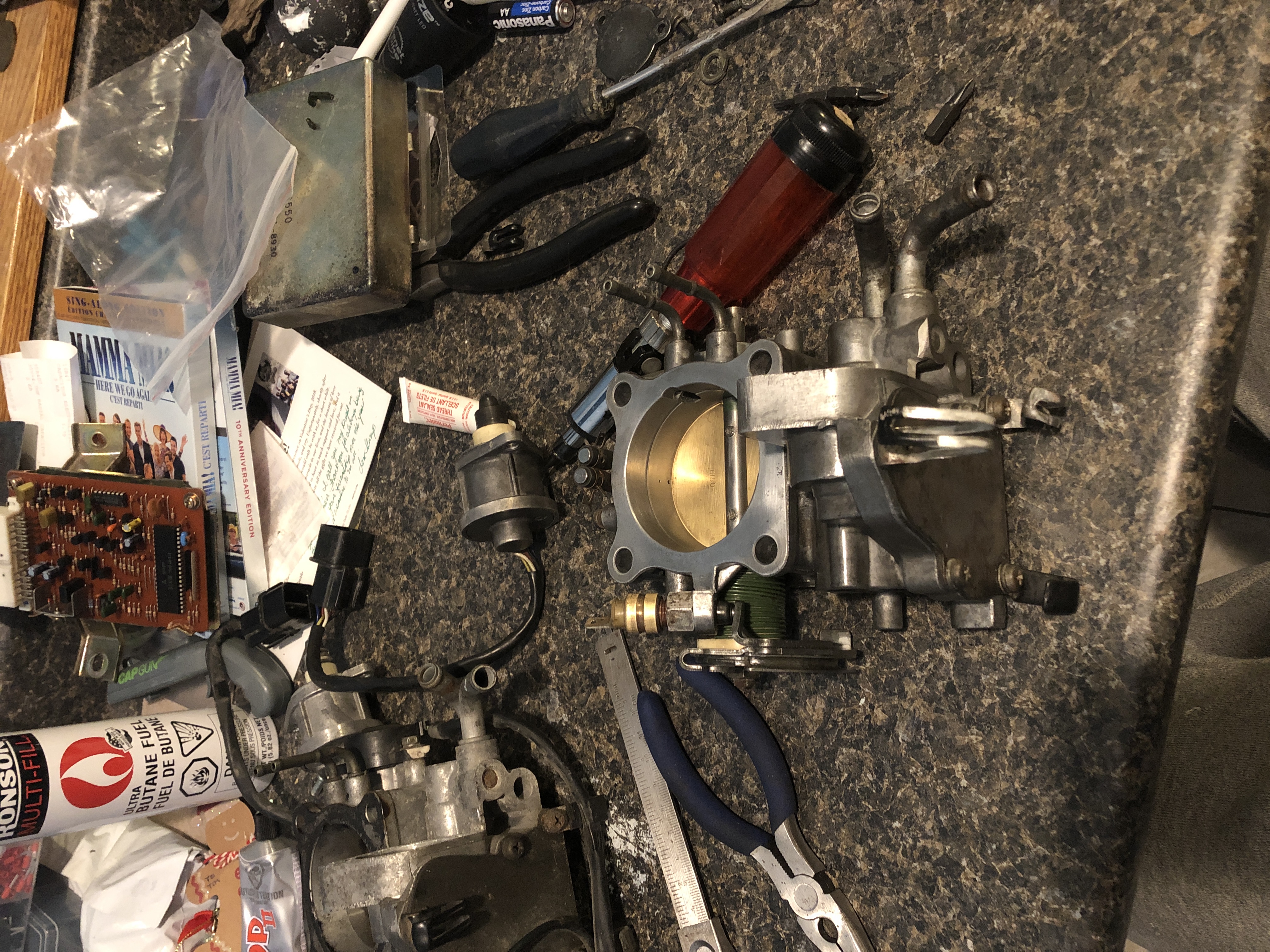

Wonding if pics show up for you folks, or not?
This is my TB all rebuilt - gaskets included, and sensors confirmed for operation and ISC motor spec's out.
Not all ISC's use the same tip profile on the extension that moves. You can't upgrade to a newer ISC on this TB until someone proves what model will fit.
The one I purchased to replace what was in there, was in no way going to work and that proved out as the car's ecu tried to compensate and then the ISC would default and no longer move.
The engine would go into the infamous up and down RPM loop - phenomenon name forgotten, but was solved with the old ISC reinstalled.
Confirmed the wax pellet opens at correct temps and also confirmed depth of plunge so that FIAV passage is open and operating at correct RPM range as intended.
That is unfortunately, another part you cannot replace. You don't want to know the price of a new TB casting!
