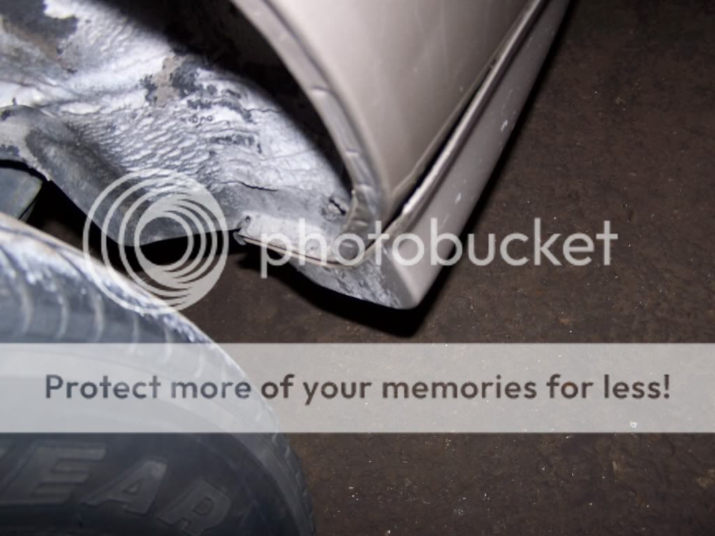

Here's a couple before photos that I took in the pitch dark with a flash:
^^^ 90 Eclipses don't have that part here in NY^^^

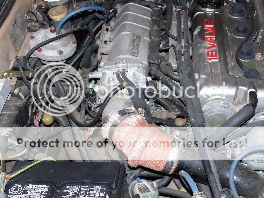

So far the No-mods I've found on the car are:
-Aftermarket sway bars front and rear(two bars in the front)

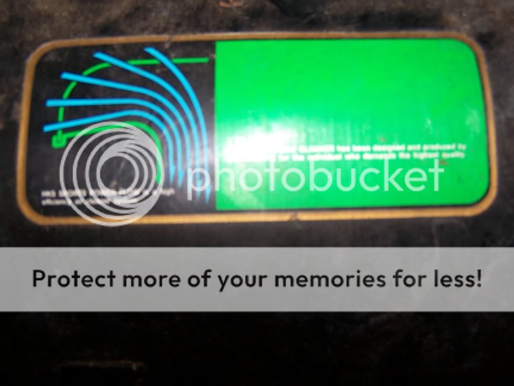

-HKS high flow airbox
-full 2.5" Mandrel bent exhaust

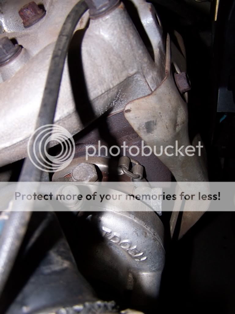

-TD05H on compressor housing
-larger UICP and 2g TB elbow
-ceramic coated manifold
-right fog lamp delete

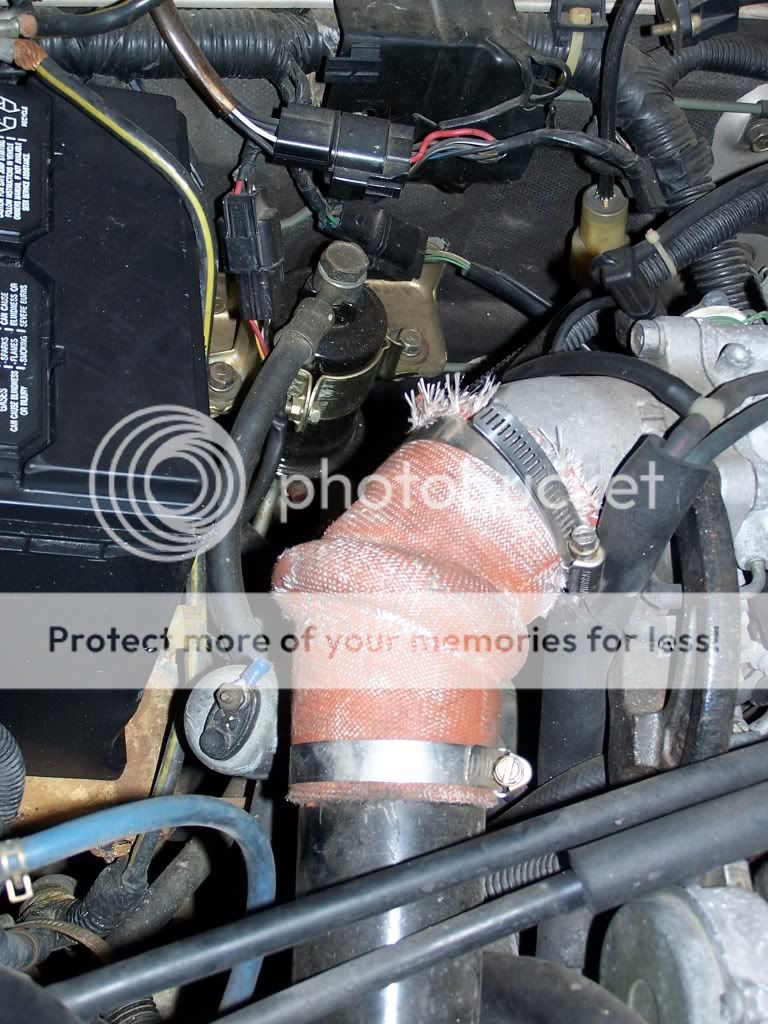

The first thing I did when he pulled up was tighten the clamp on the coupler to the TB elbow; it's a miracle t didn't blow off! We then went for a ride, and he was shocked by how much better it ran, but it still has no balls. Boost only hit's around 10 psi, but it seems it should do much better in the butt dyno department.

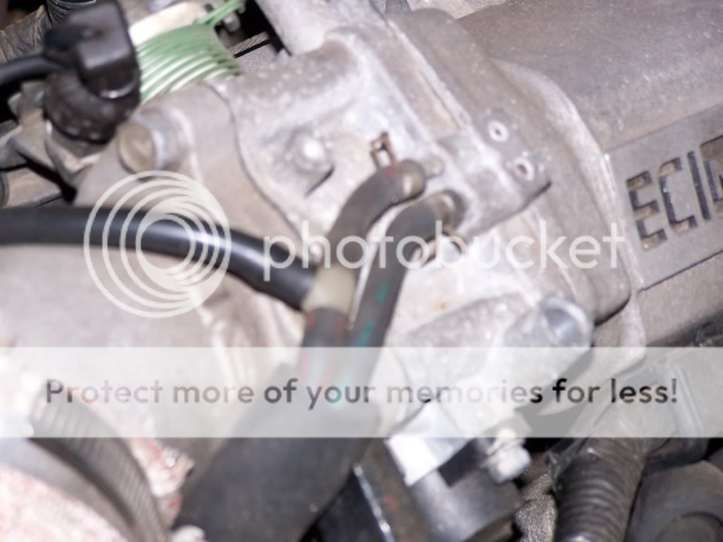

I took more pictures today. I was wrong about the 2g TB elbow, it's an HKS elbow. Image

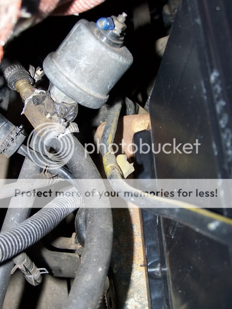

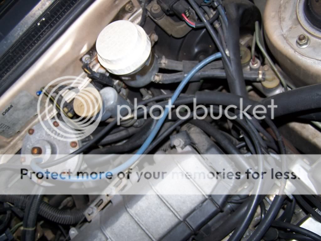

I also found some kind of dual fuel pressure regulator on it. Anybody seen this before?
There's this on the fuel supply line, but no fuel pressure gauge.

The fuel stuff looks like a Home Depot AFPR. I would pull it off and return it to stock without any of that on there. If you are going to use one, invest in a good one.
Have fun with it since it's a 90 :p Tons of stupid little things on them that will bug the piss out of you.
PostPosted: Tue Dec 22, 2009 6:38 am
Posts: 272
Location: De Pere, WI
That is not a Home Depot AFPR. The extra fuel regulator is a knockoff Vortech FMU or Fuel Management Unit. FMU's were designed specifically for super charger kits and are calibrated for individual kits based on boost. They are installed down stream from the stock regulator to add fuel only under boost. Ideally for the 600 hp goal an Adjustable Fuel Pressure Regulator such as an Aeromotive A1000 should be used. The AFPR allows the adjustability at idle and is just like a stock FPR with adding a pound of fuel pressure for every pound of boost pressure.
PostPosted: Tue Dec 22, 2009 10:31 am
Wow, that car has some old-school mods on it for sure. I'd ditch that FMU thing with the quickness.
