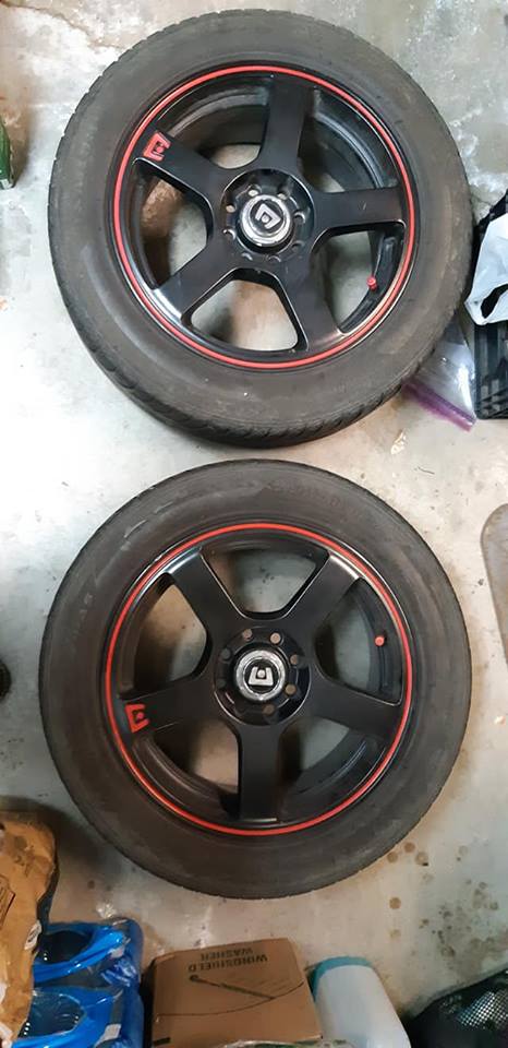

Update. As the car sits.

We are having issues with the internal file/picture hosting. The picture was hosted here as a file attachment.
I'll see about adding a pair of photos to an offsite spot to show last years set of wheels and tires and this years taller tire setup.

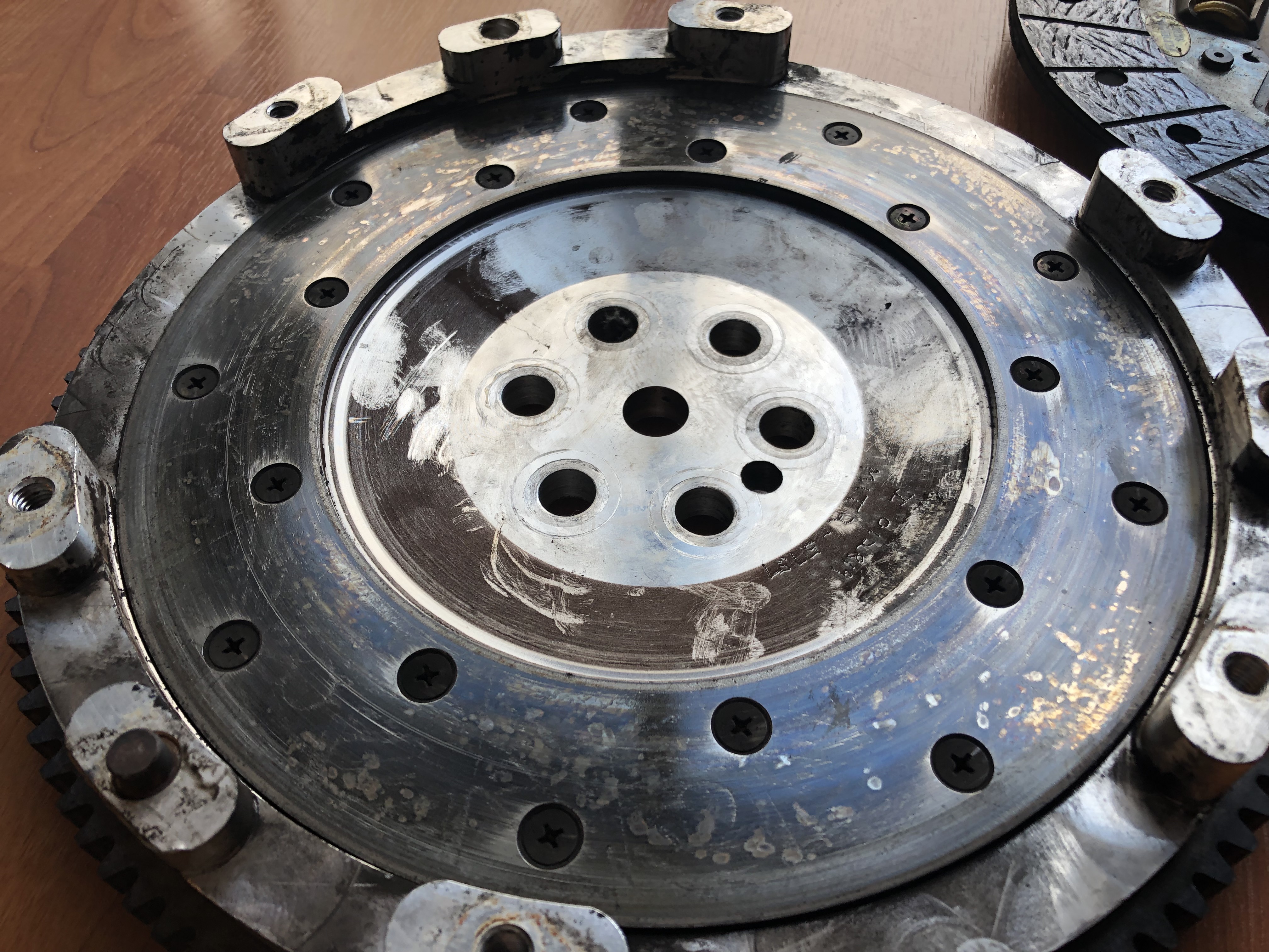

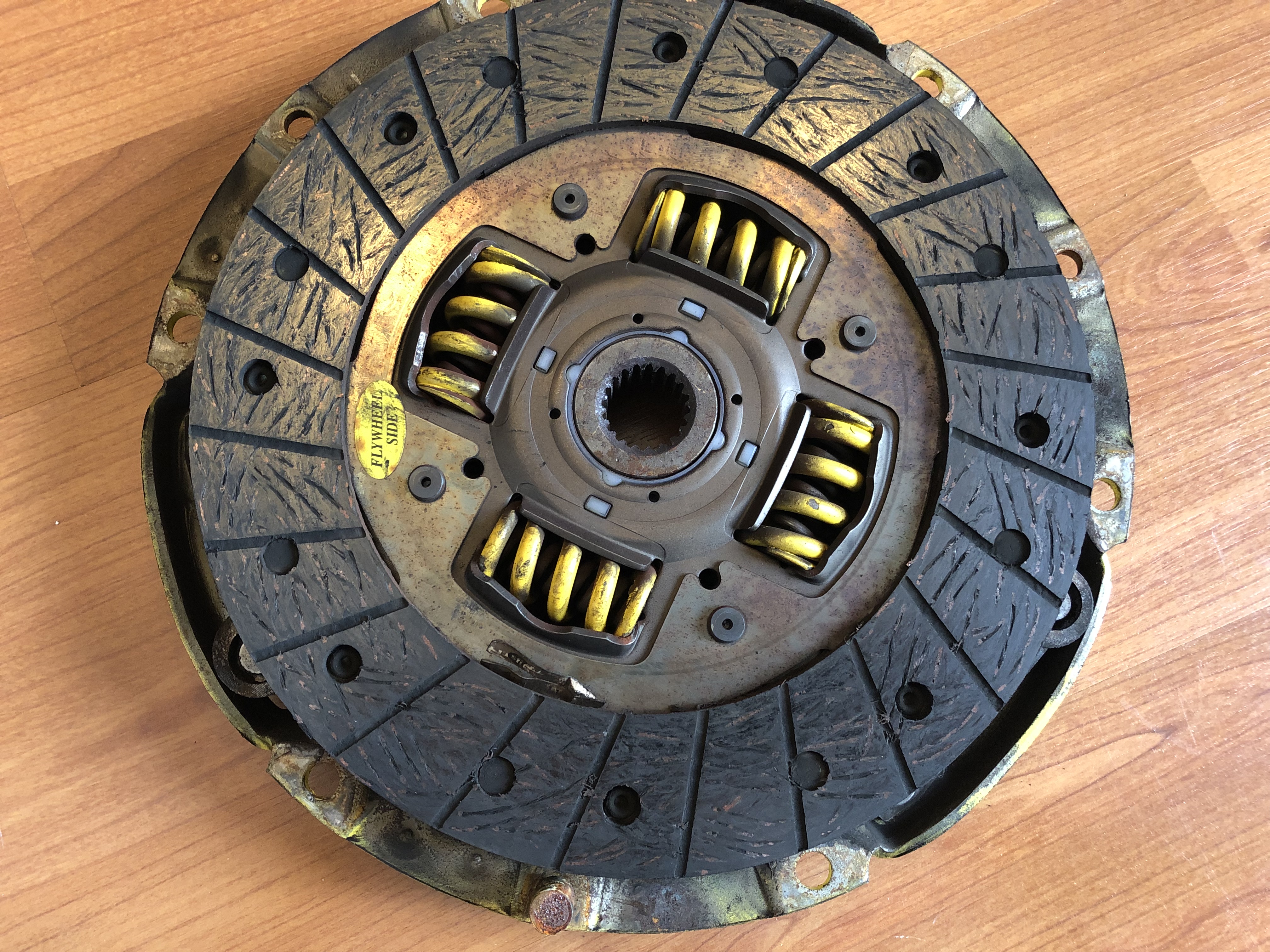

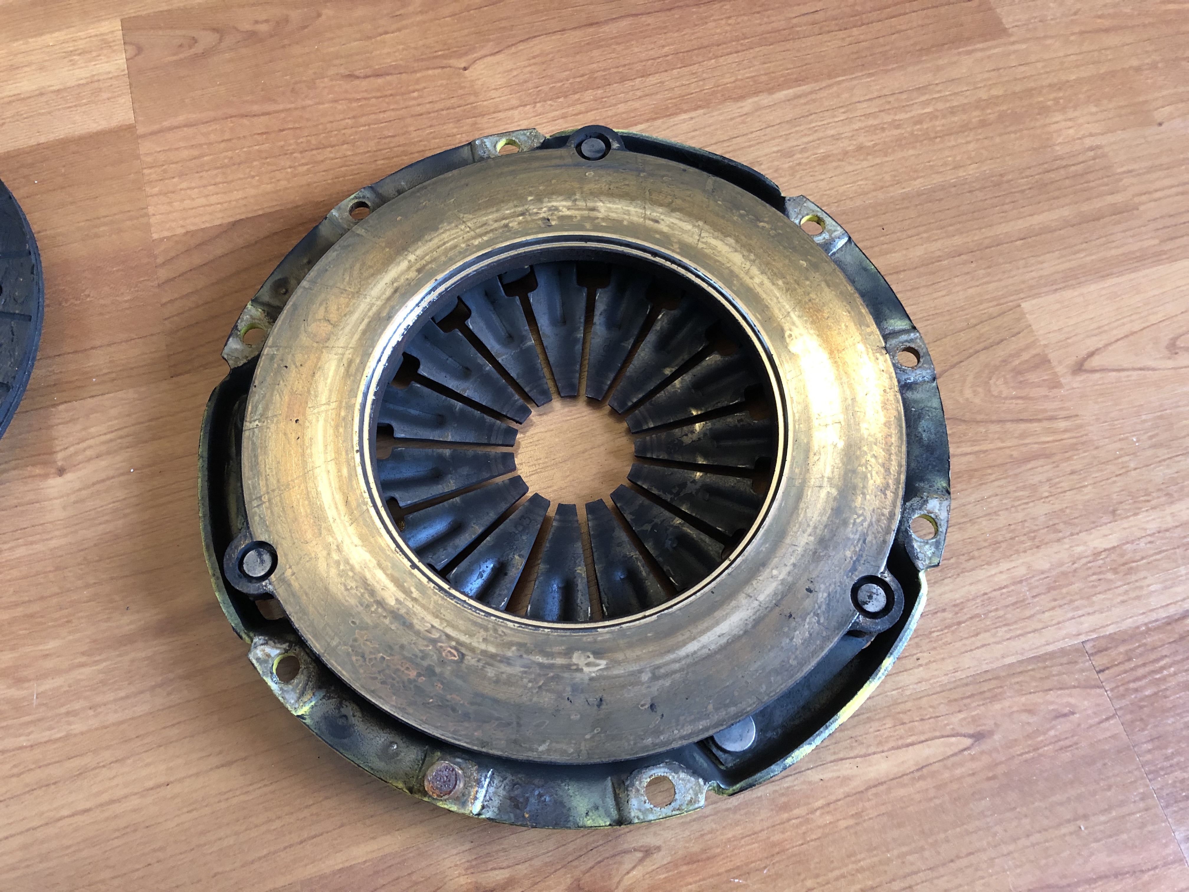

I will have my parts for sale. They have worked flawlessly since installed in 2010; clutch/pressure plate/flywheel and have seen maybe 5000km's since being installed. They got a new ball and fork in 2010, and another new ball and fork in 2015 because I wanted to make sure things were good when I took the transmission down as part of the rebuild in 2015, with the head and stuff. Only the last 2k have been with the evo3 turbo and the boost has only ever been at 12psi, so this clutch has not even been stressed. This is the HD pressure plate model, so I'll list what is being used and what will be for sale.
Clutch plate and Pressure plate:
HD/Perf Street Sprung - MB1-HDSS new price is $388.45 USD

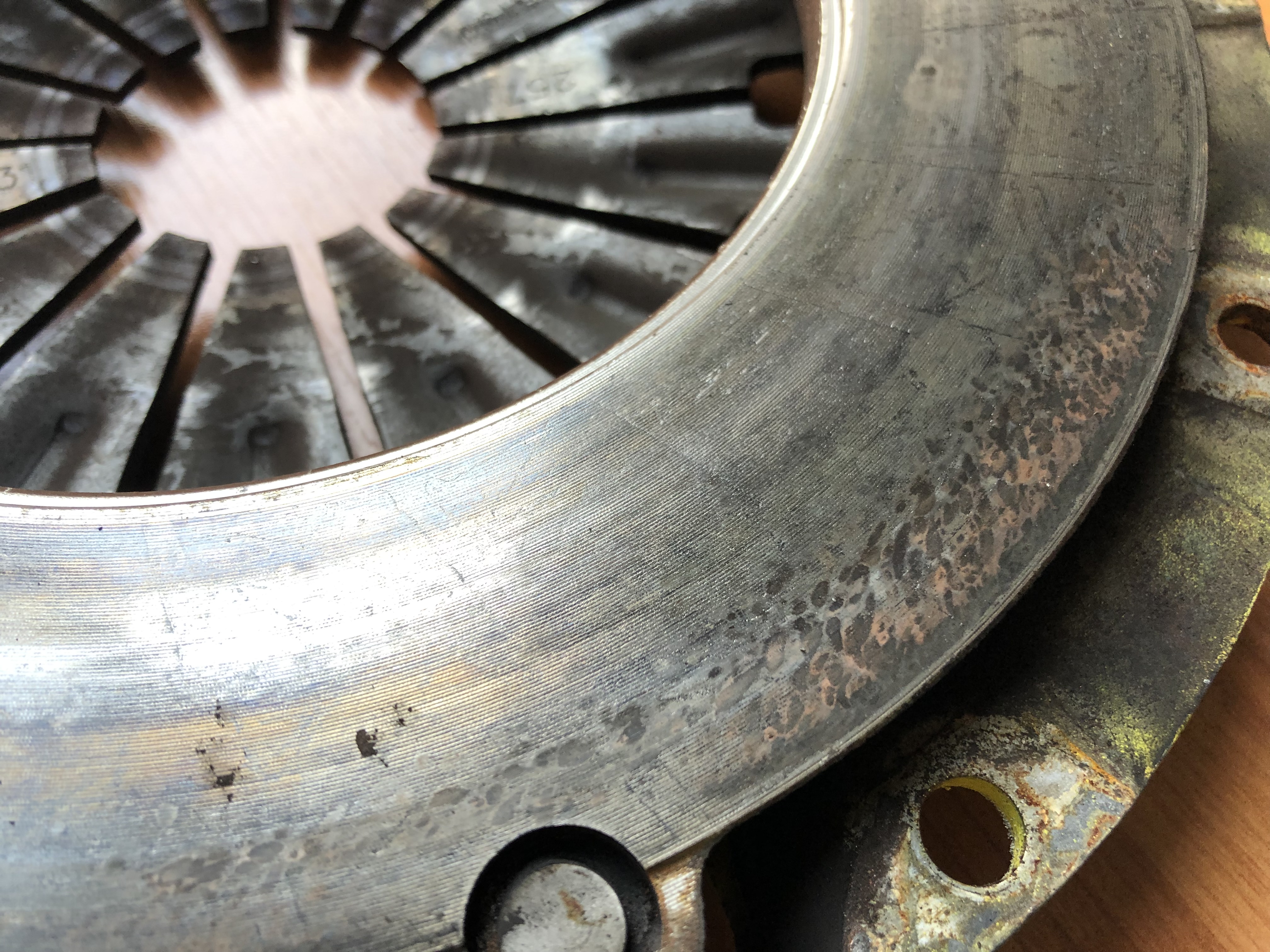

ACT XACT Flywheel Streetlite 12.3 lb - step height out of box confirmed by Ottawa Clutch at 0.610"
ACT-600155 FWD DSM 2.0L turbo GST 6 bolt
South Bend Clutch SS/TZ pressure plate and clutch disc combination
K05048SS-TZ
- stage 3 endurance setup, Kevlar disc = TZ, 2200 lb pressure plate = SS
- received a TZ disc with some anomalies, but both RTM Racing and SBC were able to sort this out for me in short order
- long story short the TZ disc had a bulge at the friction surface and as we found out the better Daiken style stage 4 center section with 2 double springs and 4 rubber insulators versus the 4 spring setup, but unfortunately they could not duplicate that as a no cost replacement. Seems during times of low stock for the 4 spring centers, they had to install the better center sections to make their productions runs so people out there almost including me, are using a center section from Exedy that is the section from Exedy Stage 1 clutch discs. Any bad press from the 4 spring center sections was from abuse and or alignment/mating issues with transmissions and engine blocks. I saw some of that evidence on Tuners when researching whether or not to see if the center section was an issue one way or another. Shouldn't be an issue the way I drive and all of the people that posted in Tim Zimmers clutch thread have no issues. Even my ACT has updated center springs and have had no issues.

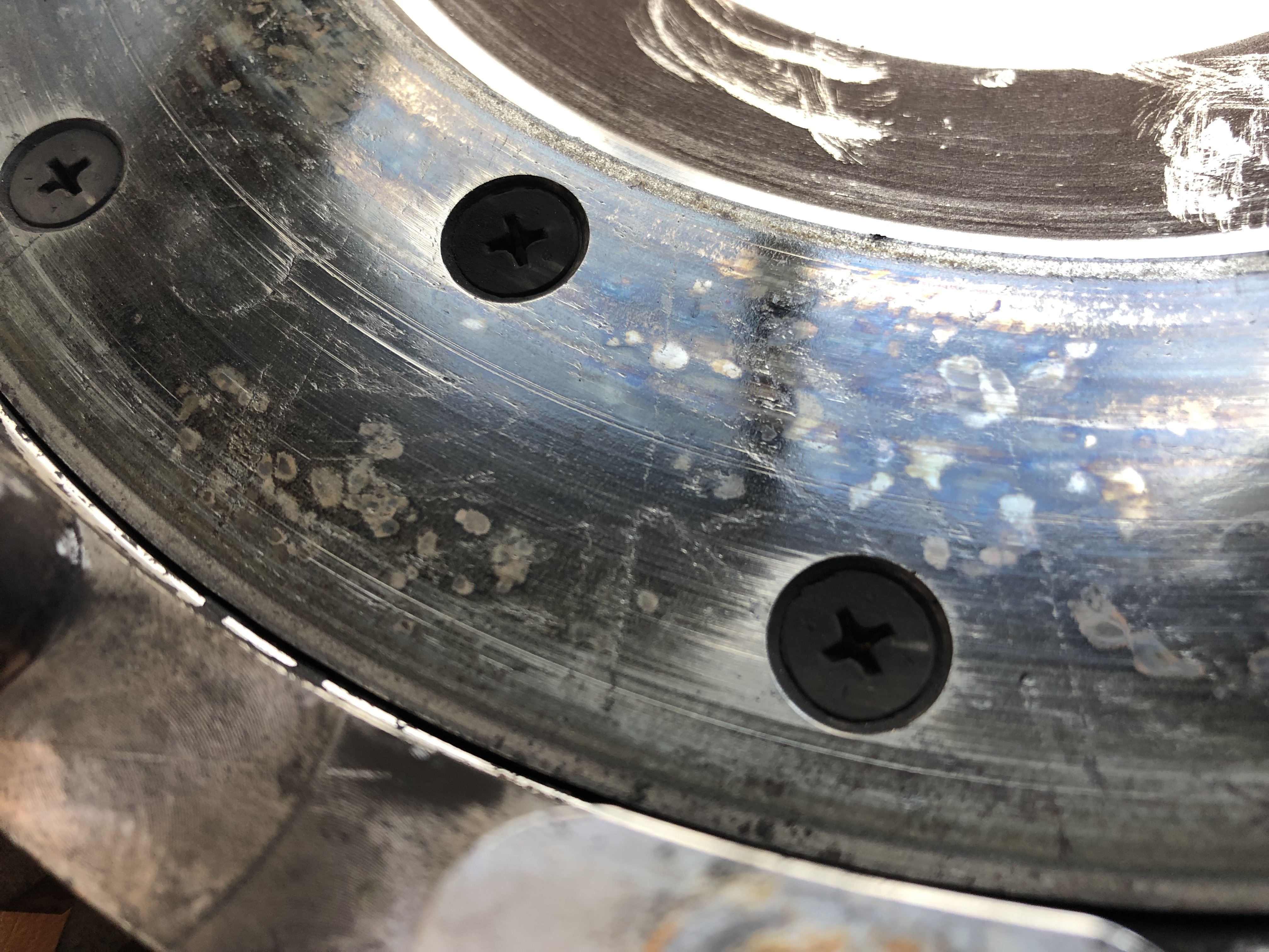

Seems I will be treating the surface of the pressure plate and flywheel with a sanding or blasting treatment that will allow more porosity for the kevlar to bed in with, greatly reducing the time until it is considered '"mated".
Tim Zimmer uses and offers a blasting service with his Kevlar kits.
Aluminum Oxide - 80/120 grit (max 40 grit minimum 220 grit)
TZ Break in mileage roughly 250-1000 miles
Chromoly flywheels take longer to bed in, because of how strong the steel is

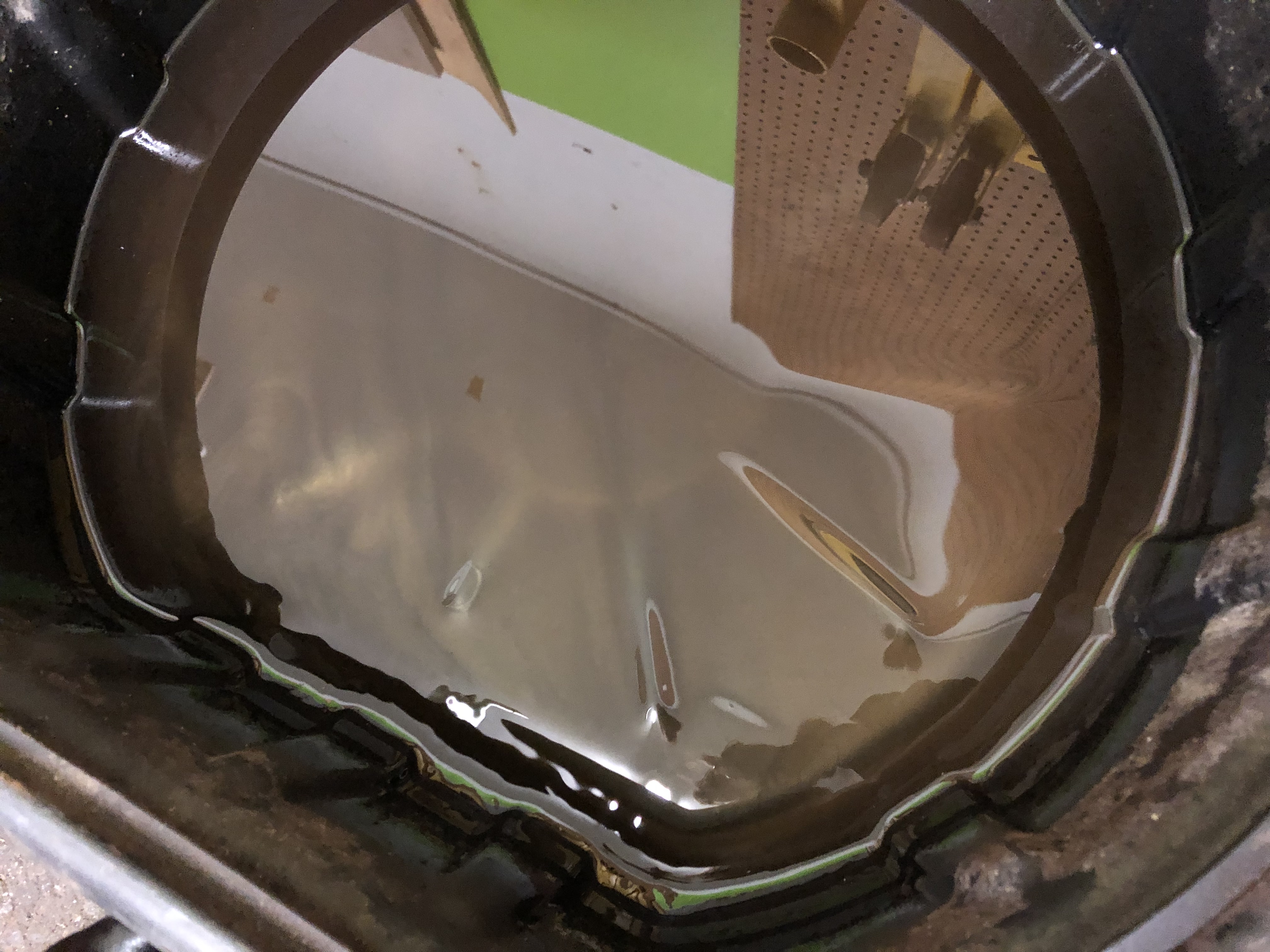

Also, pulled the F5M33.
Fluid was very contaminated at the bottom of the draining and this is the first fluid drain since the Quaife was installed.
It was pretty grey looking, and had lots of tint to it from metal particles, fine particles. Hopefully things are okay, including syncros - didn't pick up on much brass looking debris though.

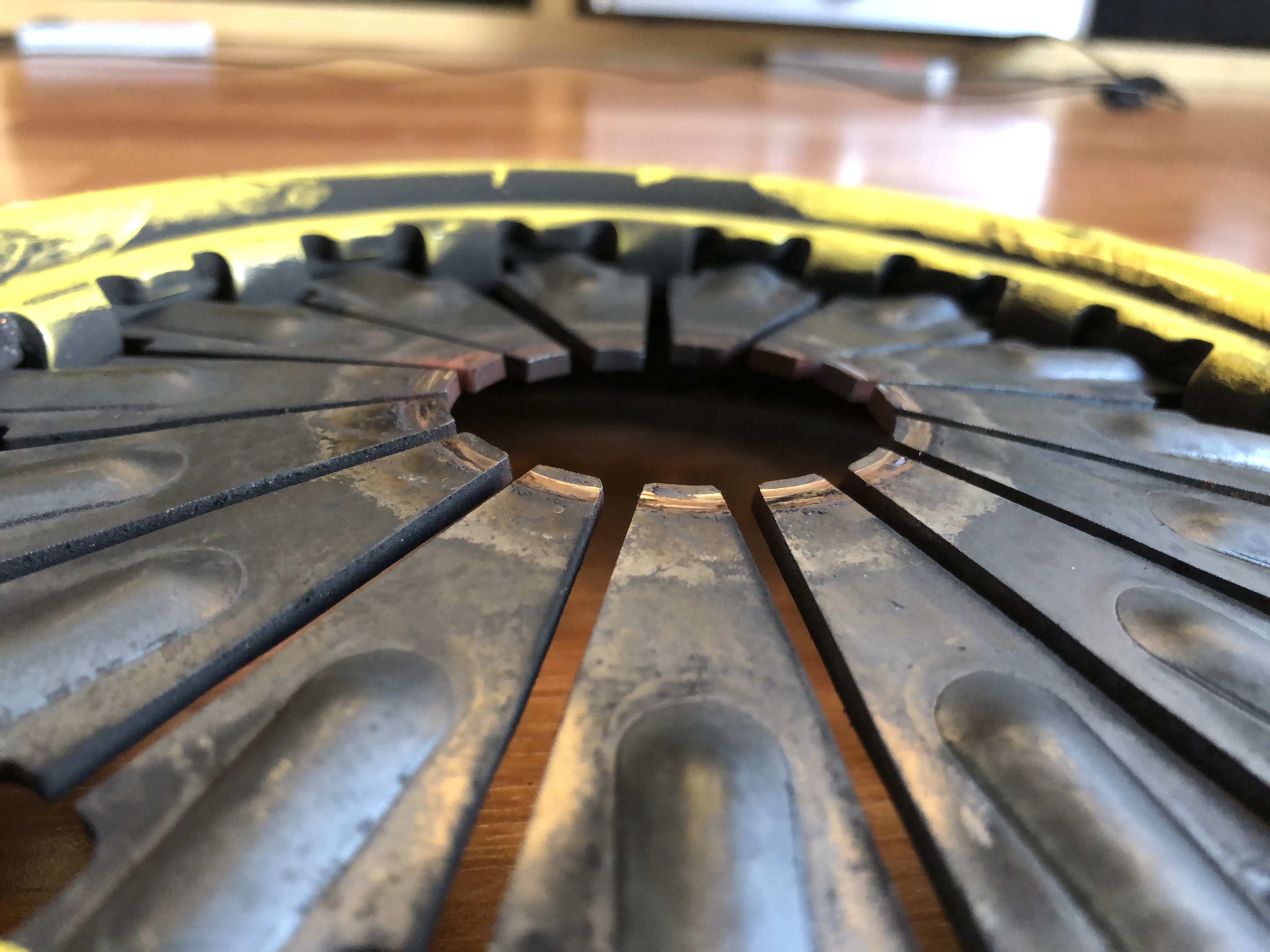

Seems the pressure plate fingers are toast. This caused heat build up on the friction surfaces, and some metal transfer from the copper in the disc plate makeup, onto very defined spots on the flywheel friction surface.
at this point the only piece worth keeping and or be able to offer to sell is the base plate for the Fidanza flywheel. The friction surface on the flywheel would require replacement by my standards, and the pressure plate is toast because of the fingers/pivot being at the wrong angles at multiple spots. Either fatigure or long throw were an issue. I can't see having too much throw as things were adjusted a few times to make sure things worked properly, but I don't know for how long this was an issue. It is not an issue where you would smell burning clutch friction surfaces, but it is one where the disc won't slow down during clutch pedal operation, because the pressure plate is lifting only partly due to angle and causing drag on the disc at that point. Some scoring, some metal transfer, heat checking well beyond what I would normally operate a clutch like (I don't ride it at lights/hills etc, but it does require lots of slip to engage this way and start off), and some surface corrosion from the edges of the disc contact plates where they meet the pressure plate and the flywheel indicating a corrosion element from extended sitting, even though mostly garaged. I have never seen that before on a friction surface. It's like the clutch didn't even have a chance to wear the friction surfaces, due to the above conditions. The pressure plate contact area still has the metal machine marks from the bit that cut it "flat", and you can tell that there is uneven wear across the areas on the flywheel friction surface, right across the flat head screw holes. I'm kind of in amazement at the condition of things. I had pulled the transmission out in 2015, to install some new pivot parts and rebuilt the clutch hydraulics IIRC (its documented here), but I left the pressure plate on, as it appeared it had grooves deep enough between the friction contact surfaces, to indicate lots of life left. Hindsight I should have pulled the pressure plate and disc. Did this occur before that or since then, I will never know. I only have pictures that glaze over the areas where the pressure plate fingers are located in view.
Now, on with the show!
File comment: These fit with no need for spacers, because they clear the calipers by a good distance. Wheel weights on the inside barrel should be a non issue now.

Oddly enough, no stress cracking across any surface where contact occurs between the clutch friction surface and the pressure plate and flywheel. I assume that if heat was deep enough, stress cracks would be showing and the parts would be structurally compromised if deep enough. A light scuff with low grit sandpaper and the friction surfaces look great.
The only way to drive this setup, was to slip/clutch in balance as you exit the garage and enter the garage, and parking lot maneuvers were painful and required some slipping and lots of clutch application to disengage the power flow.
I do have a FIAV and high OEM cold idle range that is totally operational, but this is nothing out of the ordinary and it stock so this should not be an issue.
It does however spending more time with the clutch held down, simply because of the low speed handling during really maneuvers.
Let see if more mass on the flywheel and lower direct pressure on the tob/fork/hydraulics can help make this little tin can a bit more drive-able.

Emailed Advanced Clutch Technologies about the strap/spring fingers issue.
