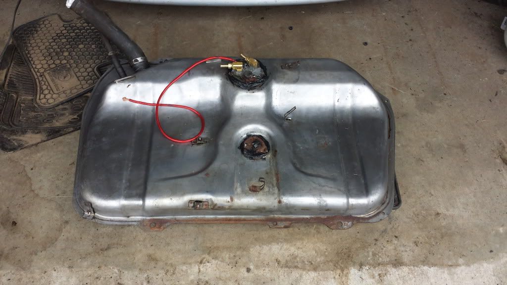

Well, the tank is out. It seems to be quite new, but instead of studs holding the fuel pump in...it's PHILLIPS SCREWS. Yeah...those wont' strip...*end sarcasm* :(.
Also broke off the inlet/outlet of the pump holder, so I'll need to redo them with some bulkhead fittings.
Oh, before any of this goes back in, I'll be cutting an access panel for fuel pump access from inside the car. I don't ever want to have to drop this thing again.

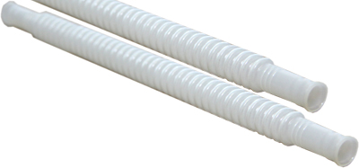

OEM GM in-tank reticulated hose :).
Right now, my install is as nice as I can possibly make it, but I refuse to worry about a kinked hose. I also have a 10ga walbro connector on the way so I can rewire right to the pump.

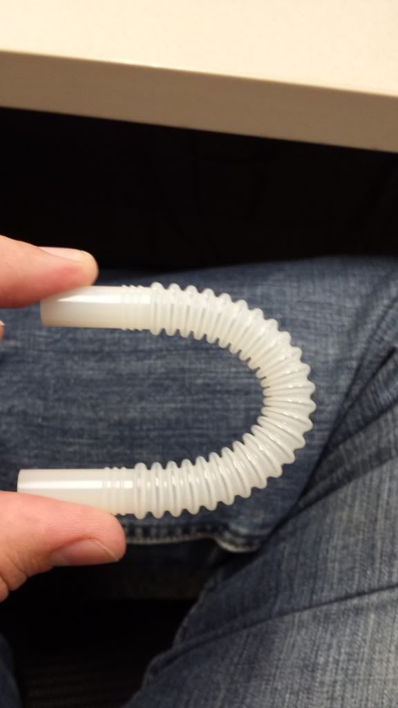

Ok, this stuff is cool. It's thicker than I expected, but really tough. That's a pretty tight radius on the bend, and it didn't kink at all.

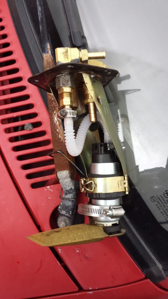

In my fuel tank, for the Walbro install. I have the Colt GT Turbo fuel bracket, and it places the pump waaaaaay out of line with the outlet tube of the hanger. I can't rotate my pump because the bracket only allows for one installation orientation. I need a very tight bend, and regular fuel hose would kink fast. This OE stuff is awesome, and completely fuel safe. Heat up the ends, slip them on, and then clamp. No fuss, no muss :).
I'll have pics tonight, for sure.

All done :).
I've swapped the feed/return, to make my life easier. This GM hose is kick ass, and it is a VERY tight fit, so it won't leak. Not a single kink either.
I'm currently waiting for the silicone (gas-safe) to dry on the wiring cover, and then I can put it in the gas tank and test fire it. I'll be doing the re-wire too, got a spool of 10ga and a 30amp relay/pigtail ready to go.

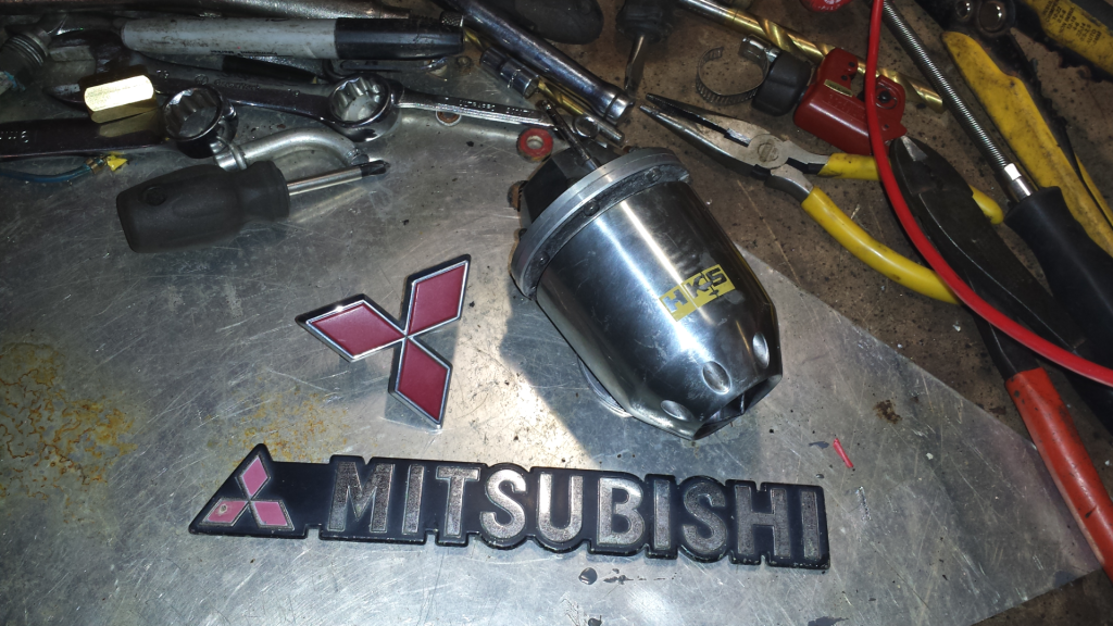

Also got a few other things. A mitsu grille diamond, hatch badge, and a genuine HKS SSQV. I had one on my Scummit, and will be putting this one on my Colt. They've gotten a bad rap, and I think it's just because so many people ended up with the fake ones. I never had any issues with mine, and the ricer in me loooooooooooooooved the sound, lol.

8 hours of obsessive cleaning :). Walbro installed and working great. I had initially over tightened the clamp at the pump, so the relief valve was wide open. A bit of loosening and everything was a-ok :).
