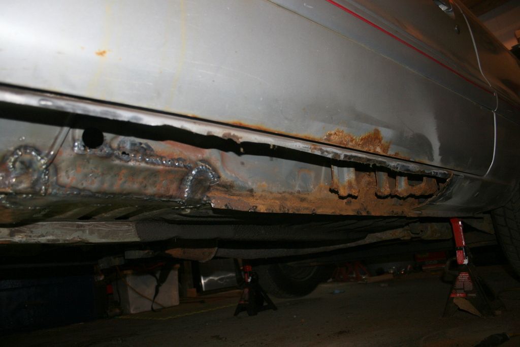

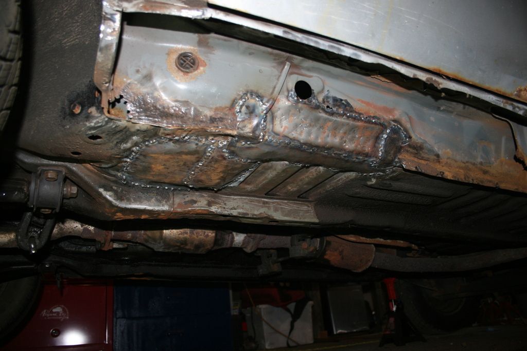

FINALLY feeling more human, so I did a bit of work. It's not pretty, but at least the floor is once again attached to the inner rocker. I am going to have to fab up a new pinch weld area, but so far everything is going well :). The welds look a little cold, but that's just due to the fact that I suck at overhead welding. I have some burns on my neck that will attest to that.
What it looks like currently:
The rest of the rocker:
The other side isn't as bad...but I think it's going to end up requiring the same work.

What kind of welder are you using? It looks like you've gone thru a few places, I can understand if you have; I'm trying to weld up my awd conversion and have blown thru more than once. (I'm thinking ahead more now and trying to weld from the top down because its hard to weld from underneath).
Keep up the good work.

Yep, it's blown through a lot. It's a lincoln 140, running .025" wire and 75/25 gas. The big problem I'm having is prep, in that I can't get the base metal clean enough, so it's tough to keep the heat down. I'm already using the lowest heat I can use without wire feed issues, so I basically just try to do the best I can.
All the stuff that's welded to clean metal comes out great though. If I had proper replacement panels I could have cut more rot out before starting, but I kinda cheaped it. The floors are all going to be covered with seam sealer anyway, lol. The rockers will be done a LOT better, since all the thin older metal will be gone :).
I also have to add, that overhead welding SUCKS, lol.
