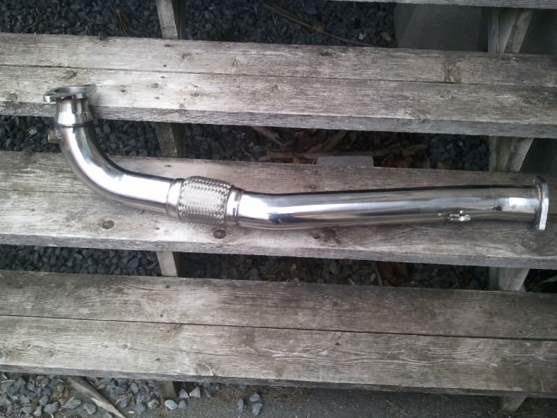

The purge of the 1.75" exhaust has begun! My 'ebay' 1G AWD downpipe came in, and is now modded for an O2 bung for the wideband. This allows me to keep the stock O2, to take full advantage of the Evo ecu's closed loop. It's all installed in the car already, and 3/4" of the stock system is waiting for disposal. The rear axle part is still there for now.
FYI, the 1G FWD downpipe would fit better. The AWD hits a bit where the control arms meet the body. Once the rest of the exhaust is on, it will clear just fine though.
