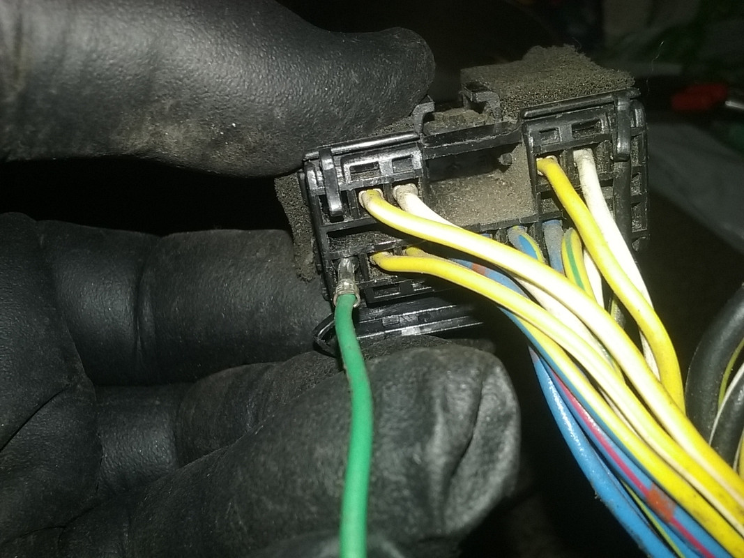

Notes: Because the Mirage uses the same 3 yellow ECU pin connectors as a dsm ECU I will simply unpin the dsm ECU pin 7 black green wire and put the mirage green yellow wire in place, then find pin 65 red blue wire and put the black with white stripe wire in that slot, additionally I plan to pull the both the black green and red blue wires all the way out of the dsm engine loom since they no longer serve a purpose.
Imagescreengrab
This is the green wire it will go to pin 7 of connector C-19 which is pictured above.
