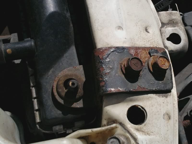

The PO of my swapped Colt made his own upper brackets,from the looks of it. Works great,sits a bit lower than stock I believe. I don't think anything was done to the lower mounts.
correct also... the 1g dsm rad is not as tall as the stock csm one.. I didnt have access to metal to make a new upper mount. so I ended up just raising the lower ones.(you unbolt both bolts..move them up and only replace 1 bolt).or you can do like in the pic.. mount the rad and make some kind of upper mount to hold it in place..
I wish I had a pic of mine.. the stock upper mounts I had to flatten out with a big hammer.. so if u can get some metal. it might be easier to make the new top mounts. :rock:
