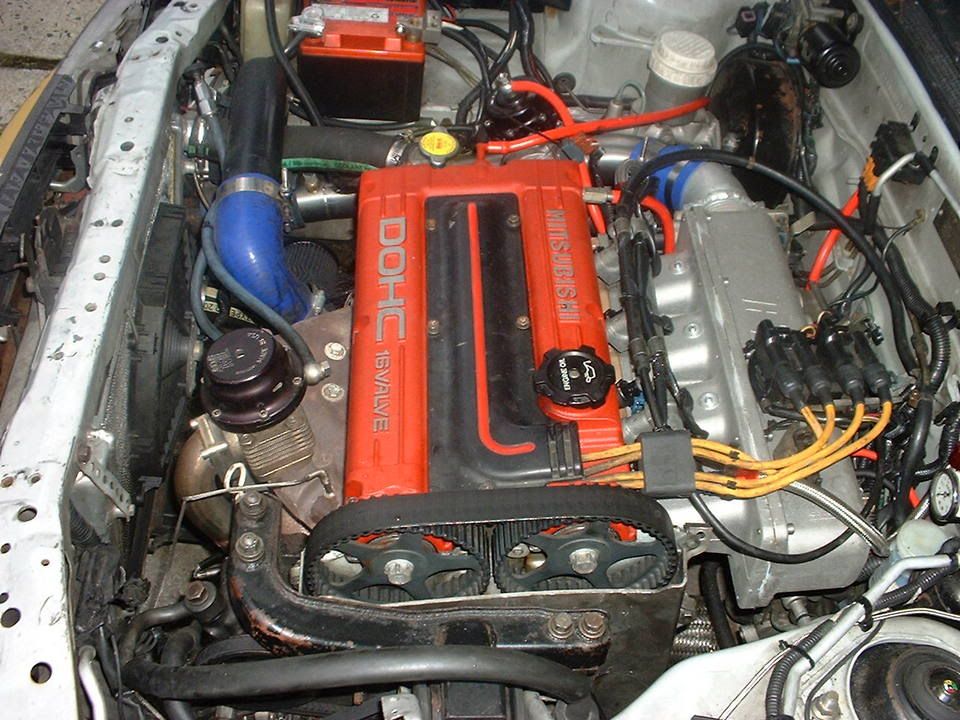

I have a 38mm and it fits just fine.

Well that gate looks like a 40mm gate there but they may have changed the design on the 38, how old is it? Good new for the guys lookin manifold mounted, because it looks like it fits great. Well thanks antilag for the info about the oil filter and dipstick. I'll take some pics of everything and post them on here when the parts are being put together.

mowlgi it looks like in that picture you move the radiator and placed it under the support brace giving you almost a good 2 inches of clearances, damn wish I had thought of that insitead of going with that stupid honda radiator
w
Yeah Aluminum 1G radiator, i dont know who made it. I am also not sure on the age of the wastegate. I was told it was a 38 so, whatever. If it does its job why complain right?

got any pictures on how you mounted/moved the radiator???

thanks for the info mowgli, your gate is a 40mm they did not make any square flanged gates in 38mm , their 38 mm gate basically is a 35mm body with a 40mm head and a machined out valve, like you said it works so why bitch

I will try adn get more pics of how the radiator fitted. And it is helpful as hell to have it there, just look at the room i have for the turbo. Plus i have some more space if i plan on going bigger.
