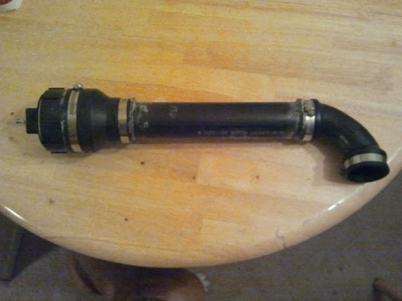

Home depot Boost leak tester. Image

Wow. We usually make them just bolt right on the front of the turbo. That thing is huge, but will likely get it done.

Makes it easier for sure!

I tried to make it fit directly to the turbo but lower water neck and fan were in the way. With this The car is completely together and I can do boost leak tests :D
