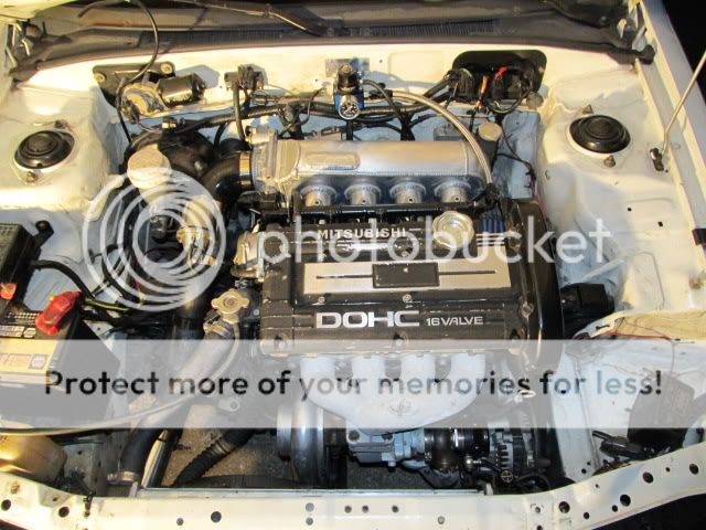

Since these vids were taken I've put on a bigger intercooler and a JMF Drag with a Q45 throttle-body. It definately is not a "bolt-on" affair in this chassis, but I've been making it fit (sledge to the fire-wall, solid mounts, yada yada :twisted: ) Anywho, on to the pics!!!
Old intercooler setup

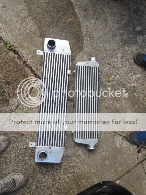

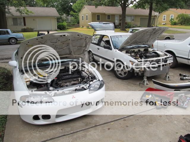

New vs. Old New 34.5" end to end, 8" tall, 3.5" thick

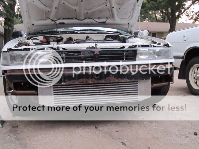

Test fitting the new core. My friend Jeremy's GSX

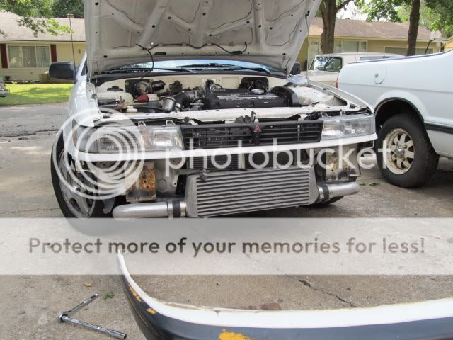

New core mounted. Finally got the rebar to fit haha. Lots and lots of cutting :drinkers:

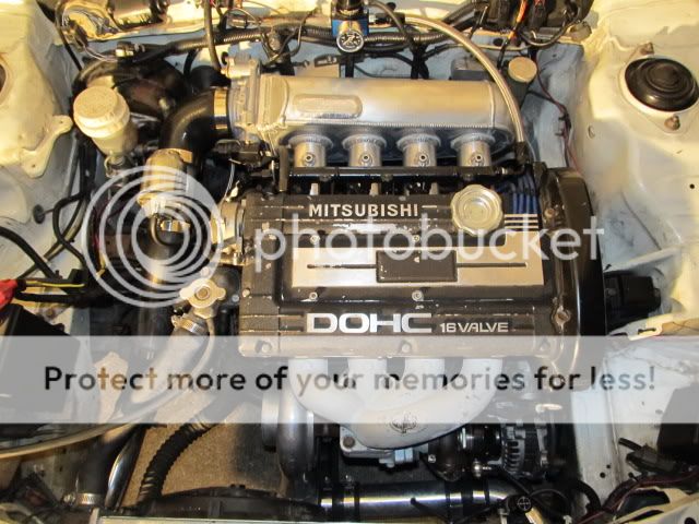

Stock Intake manifold setup

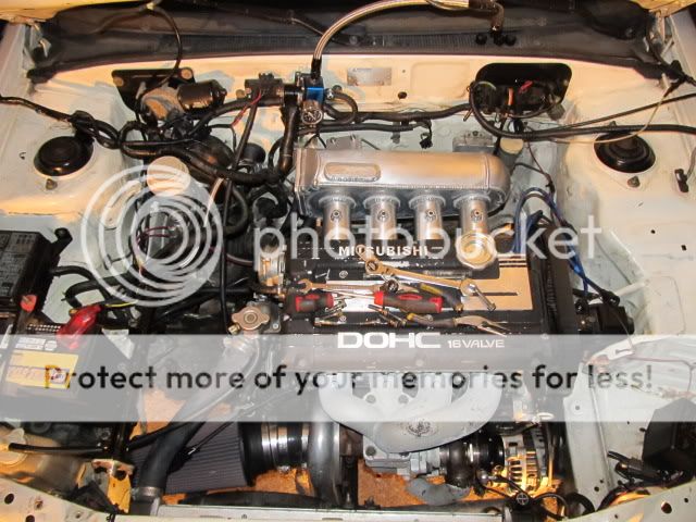

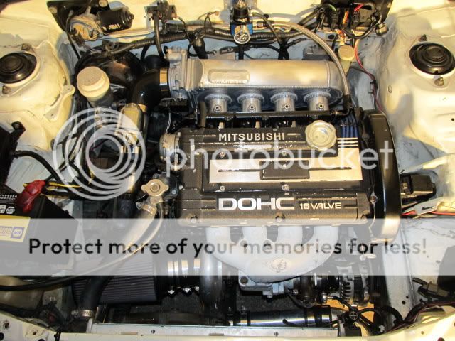

Making room for the JMF

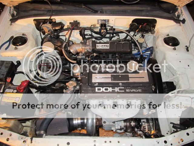

All finished up!
It took a solid weekend to do that job. We took our time on everything and made it as clean as possible though. I haven't got any new videos with the new goodies yet. I'll try to keep you posted when I make some.
