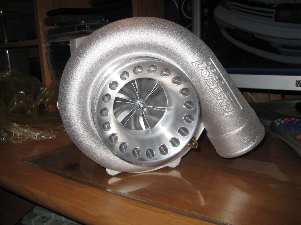

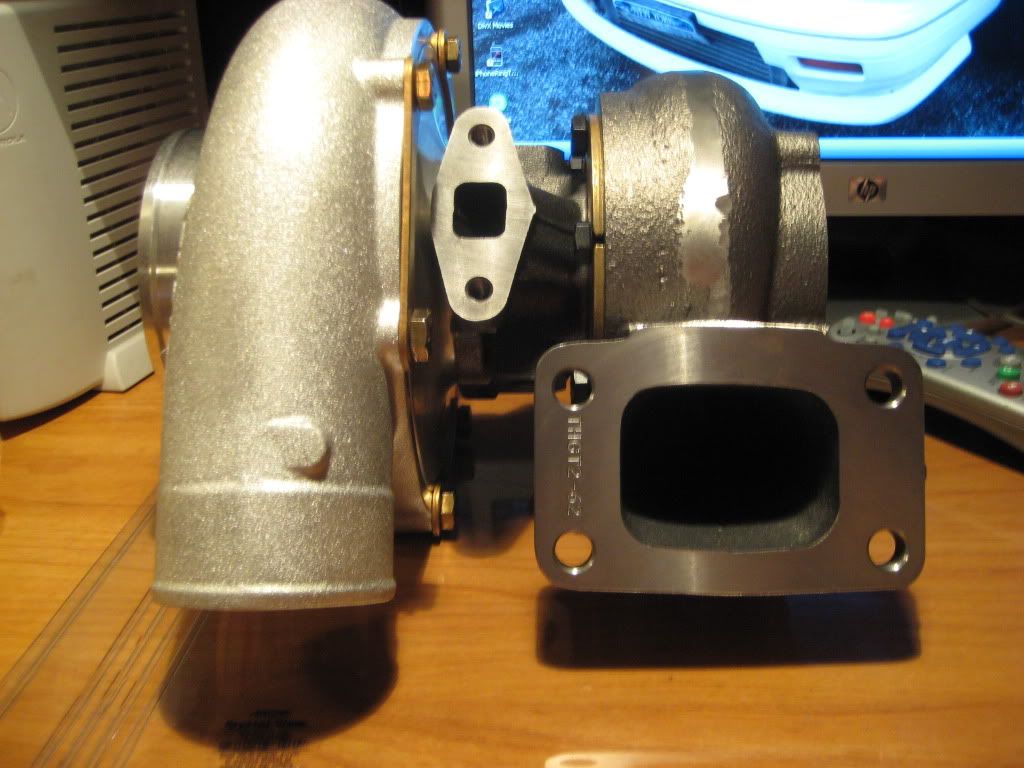

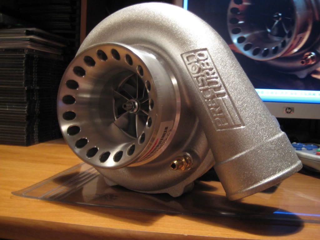

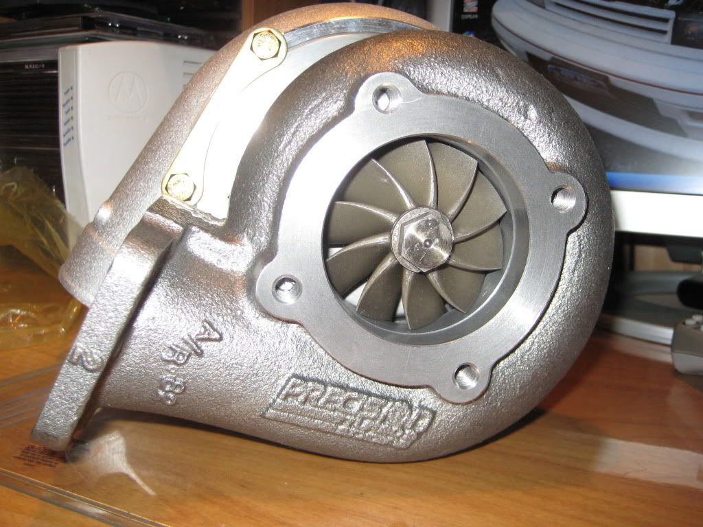

Precision hp6262r with a t3 82ar. hopefully once i get the car back up and running i make some good numbers. mike at awd motorsports went 8.98@156mph with the same turbo.

Very nice. I'll be interested to see how quickly that thing spools. It's basically PTE's version of a 35R HTA, right?

Will the hood still close? :P
Looks good, can't wait to see what it will do.

lol, yeah the hood will still close. people say it spools faster than a 35r. im not sure if its similar to hta35r, i have to google it. the blades are billet aluminum rather than cast. the turbo is rated for 680hp but people have been making way more power than that with them. chrispeed at awd motorsports made 784whp with the exact same turbo on a full interior evo with no nitrous. there really impressive.
