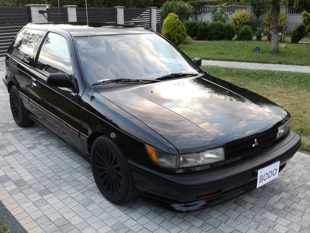

Front...

PostPosted: Fri Oct 18, 2019 7:48 pm
Joined: Wed Aug 01, 2012 2:01 pm
Posts: 58
Location: miami, florida
Quite bit of work and patience, but the results look real good, congratulations.
PostPosted: Sun Oct 20, 2019 3:38 pm
A LOT of work you did-and the results look fantastic!
Let’s see some interior and under hood pics.
PostPosted: Thu Oct 31, 2019 4:25 pm
Biggest build to date on one of these, in terms of restoration that is!
