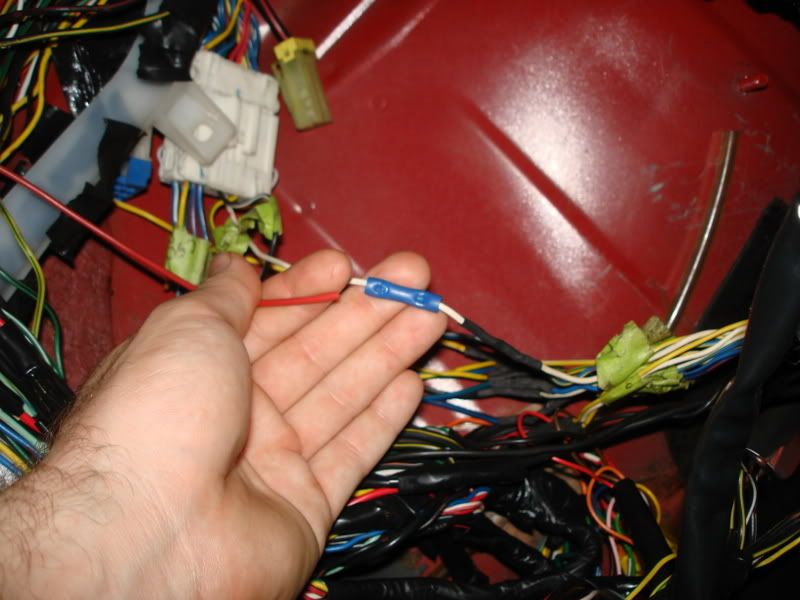

picture time!
this is the fuse that im talking about that wouldnt stop clicking, it has since stopped since the wiring is back to normal
the green/orange wire is the stock wire for the intake air temp, pin 8. you can see where we had the red wire that goes to the wideband and how we put it back to stock as well
that white wire that is butt connected is the dash plug wire, the one that lilevo says to splice in there, you can see the red wire was vampire connected before but now is back to stock!
this white wire is the wire that leads to the tach filler, we had it cut and go straight from the tach filler to the white dash plug wire

Did you happen to unplug anything under the hood? It almost sounds like something was left unplugged or either the ecu took a dump. Do you have any buddies with a known good 91-94 ecu?

checked the mpi fuse, it works fine
checked for pulse at the injectors, nothing, so i am assuming i need another ecu :(

well i put in a local dsm'ers good ecu, and the car fired up! so should i send off my ecu to get resocketed and capped or is my ecu done for???
PostPosted: Thu Aug 30, 2007 10:18 pm
Find someone that knows what they are doing and I'm sure it'll be repairable. Have you opened the case yet just to see what it looks like? I remember that ecu being one of the cleanest I had ever seen since it was from a 94.

It works (the car that is)! I sent the ecu to terry posten to get re-socketed and cleaned and he also seated the dsmlink chip properly in my ecu and the car runs. I cant drive it cause im waiting on my smaller intercooler but for anyone in the future with similar symptoms, CHECK YOUR ECU!
