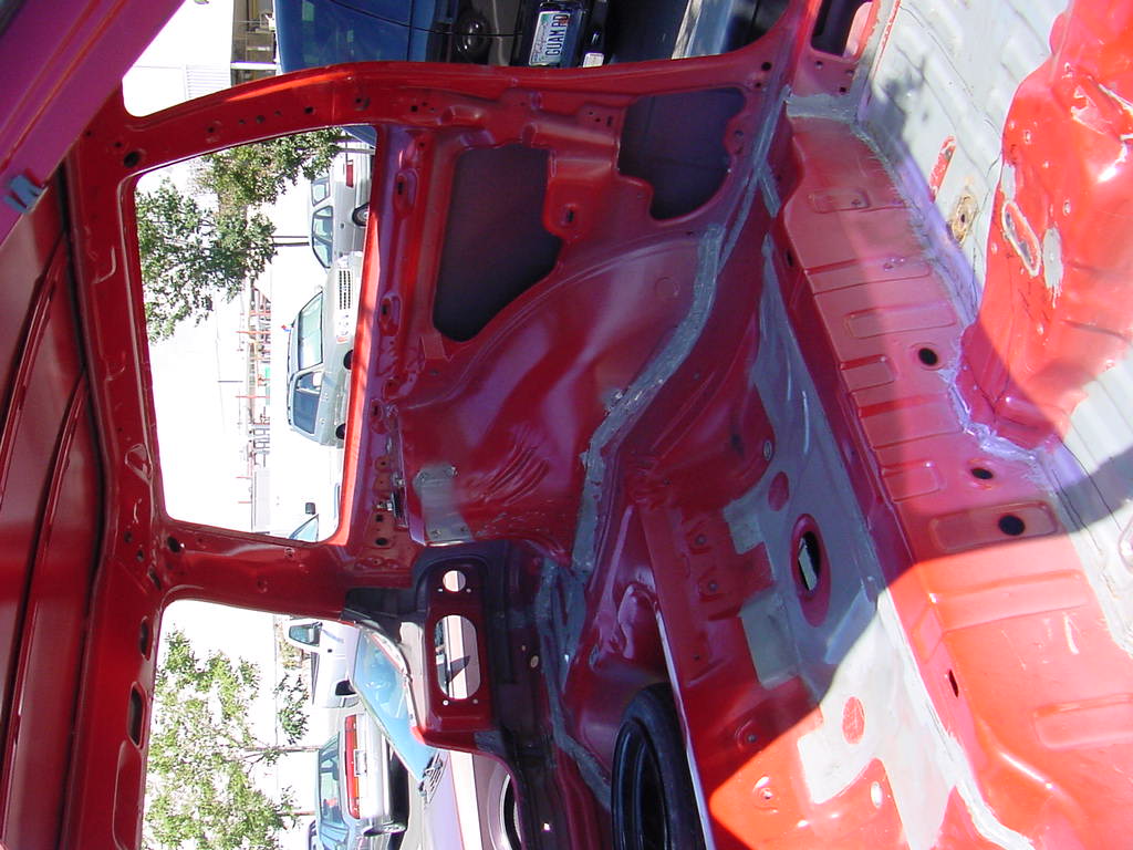

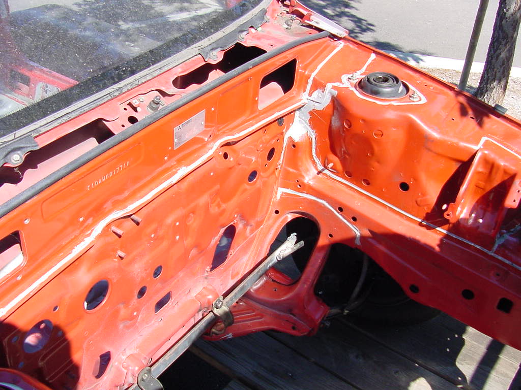

Here is the link for his stripped car. If anyone wants they can look in there and circle places i should weld. That would be greatly helpful. I will be doing that later. This is what the car pretty much look like right now.

So the rear strut towers, should I weld the seam weld where the curved sheet metal that goes around the struts connects to the flat sheet metal along the body? and down were the frame is?
And the lower control arms braces, i am guessing welding is needed on all of those seams, by the frame, by the fire wall, by the triangle that looks like a brace

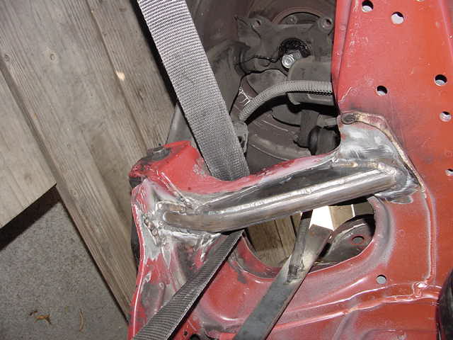

It looks like they added a brace in this picture
And a brace on that side
Seam welded all of those spots

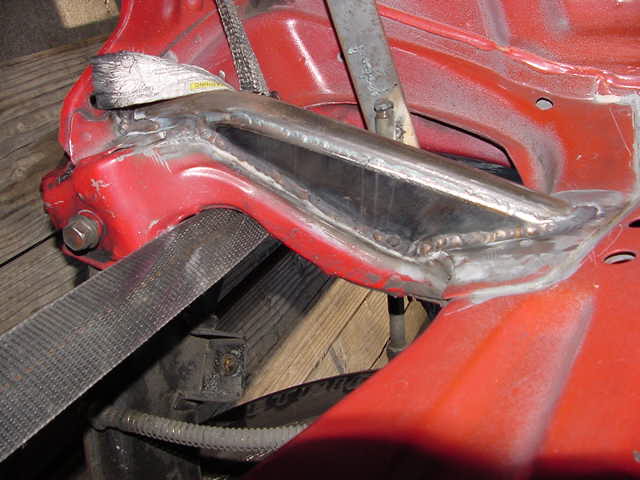

Another picture of control arm brace
That will be a start for me
