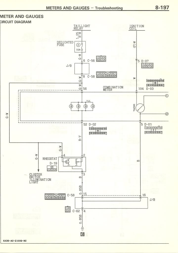

I made a little progress this afternoon in the 15 minutes that I got to work on it before it started to rain. If I unplug connector C-58 all of the parking lights and the license plate lights work without popping the fuse. I guess this goes to the dash lights. I de-pinned wire # 8 which is G/W and plugged it back in and the fuse still doesn't blow so I've narrowed it down to this one being the problem. Here are the wiring diagrams for the Meters and Gauges section if you guys have anymore ideas for me to try.

It looks like #8 goes right to the dimmer switch (rheostat). I think you have a bad dimmer switch. #8 goes right to the dash illumination but is branched off to the dimmer switch to vary the voltage going to the bulbs. Also check the pins #52 & #56 on plug D-02 to make sure that are making 100% contact. See if you can track down where #1 goes on plus D-19 (dimmer), I can't find it on the diagrams above.

Another slight update, the turn signals are indeed working. I'm assuming I didn't have the car switched on last night when I tried them :rolleyes: . From what I can tell when the G-W wire on C-58 (pin #8) leaves the front of the fuse box under the dash it goes up to the dimmer and illumination lights. This morning I pulled the cluster, unplugged the dimmer (D-19) and both of the small illumination plugs (D-04 & D-21) and put pin 8 back into C-58 and tried to plug it in and the fuse popped again.
Also when the fuse is good if I unplug C-58 and put a test light onto the pin sticking out that pin 8 would plug into and turn on the parking light switch it has power. What I don't understand is that if I unplug everything that the G-W wire goes to after C-58 then why does this fuse still pop? Does this mean that the problem lies in between C-58 and the other 3 plugs (D-19, D-04 & D-21) somewhere?

Drawing 8-197 shows that the G-W wire splits off and goes to the cluster switch illumination light, have you tried tracking that down? Can something be grounding itself out on a piece of metal? You have narrowed down the circuit that is giving you the issues, you will just have to track down all of the end points see if there are any issues there. Wish I could be there to help... Its so much easier to troubleshoot when its hands on.
