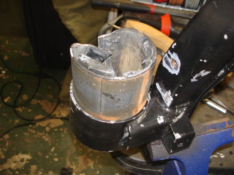

So I finally decided to get around to installing one of the poly motor mounts I bought from summit. The part number is 13-501 and this is the for the timing belt side, which is a hyundai elantra mount, the front mount already has a poly motor mount, its a stock 1.5 mount, the rear is about 1/2 smaller than the timing belt, which the rear is also a stock 1.5 mount as well, and I havent removed the tranny side yet.
Pics!
stock elantra timing belt mount, really really soft rubber!
rubber removed with a drill
theres a metal ring on the inside, we used a sawzall and cut a slit in it, then bent it with a hammer and large screwdriver, then it popped right out! or you could cut 2 slits in it and try that as well
its out!
and the 13-501 mount is in, with some grease!
next up, stock 1.5 rear mount! Just gotta find one thats prothane :wink:
